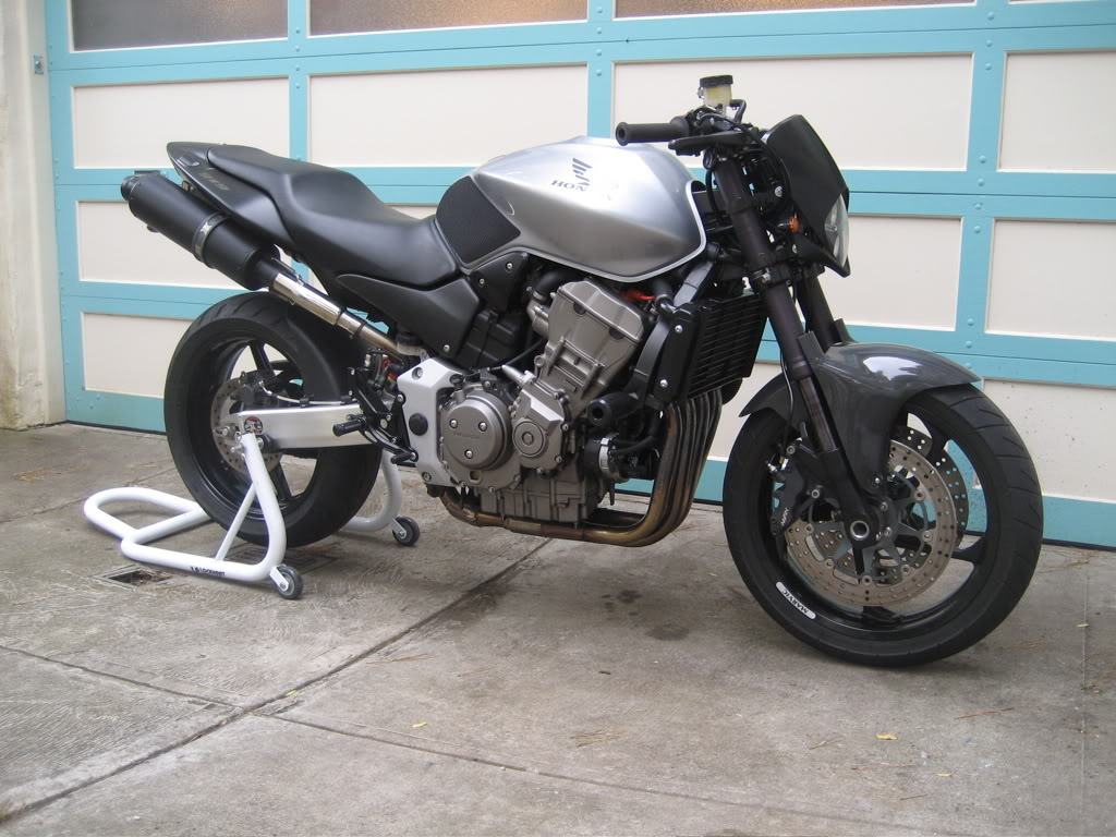

2001 naked, I know, but it turned out nice reeel nice

Originally Posted by stebbdt
CM I gotta ask, the bike in your avatar, does that have a Tracy body on it?
it's a Tracy body on a cb750k

Awesome, it's exactly how I want to build mine after the fork upgrade, but with a front mount rad.
Very good work

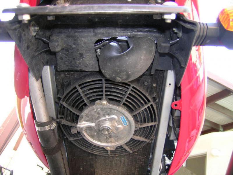

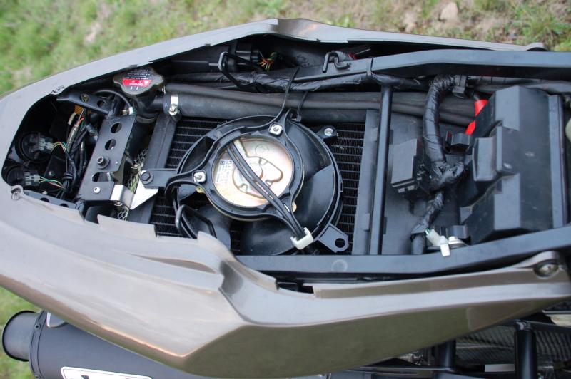

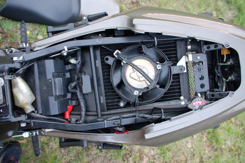

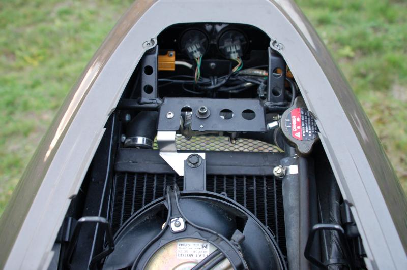

Originally Posted by kai ju
Hey VTS,
Nice bike, where are the pics of the radiator, fan and plumbing ?
I've been bugging you for over a year, I'm tired of waiting.
Your bike does look nice, I really like the color combo.
BTW, regarding range issues, I have a 1998 to 2001 VFR tank I'm getting ready to convert for Superhawk use.
It's a Canadian tank in a teal color, but is in excellent shape.
I've got my tank off so that I can make another fuel pump block off/petcock mounting plate.
Let me know if you're interested.
It's interesting to read the positive comments about your bike, which echo the comments made about mine several years ago.
I do wish somebody at Honda was listening and would take a look at our bikes and realize that there might just be a market for a naked twin.
Kai Ju
Here they are, thanks for being so patient.
Like I said, it's still not quite done but it works pretty good right now.
I think this winter I'm going to turn around that thermo lid like you suggested.
I'll install the ignition advance at that time too being the coolant will be drained. I hear that helps mpg on this bike some....
On the tank I think I'm going to come up with some sort of aux tank like some of the iron butt riders put on their bikes. Have something custom made to fit on the back seat for any touring I might do on this bike, still waiting to hear back from chickenstrip on how to install hardbags.
VTS
Attached Thumbnails 2001 naked, I know, but it turned out nice reeel nice-dsc_0023.jpg   2001 naked, I know, but it turned out nice reeel nice-dsc_0020.jpg   2001 naked, I know, but it turned out nice reeel nice-dsc_0024.jpg

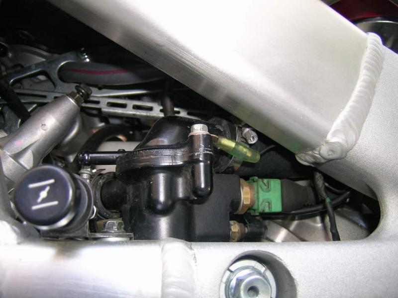

VTS
It looks really clean and quite different from what I expected.
With the custom radiator you were able to retain the stock battery box and associated wiring, nice job.
How often does the fan cycle ?
At what temp does it come on and when does it shut off ?
Just a word of caution, when I first built mine I thought one fan was enough, only to find out that at 100 plus ( temp and speed) it wasn't.
You don't have room for two fans on top but might have room underneath.
I still have that fan, let me know if you want it.
Here is also a pic of the thermostat housing lid turned around, to give you some inspiration.
Kai Ju

So Kai ju,
You have a pusher fan on top and puller on bottom? Is that what I am seeing.
Old Oct 19, 2009 | 08:36 AM
  #51
VTS's Avatar
VTS
OCMD honorary member
Joined: May 2007
Posts: 252
From: Olympia, WA
So Kai ju,
Yeah I just re-read your message to me, They are above and below, but are you pushing out of the inside seat area, or are you pulling in with the two fans?
VTS
Old Oct 19, 2009 | 09:36 AM
  #52
kai ju's Avatar
Joined: Jun 2005
Posts: 524
VTS
The fan above the radiator is a pusher, the one below a puller.
I no longer have that set up, I'm now running two pushers from above the radiator,i.e. hot air exits down towards the tire.
Kai Ju
