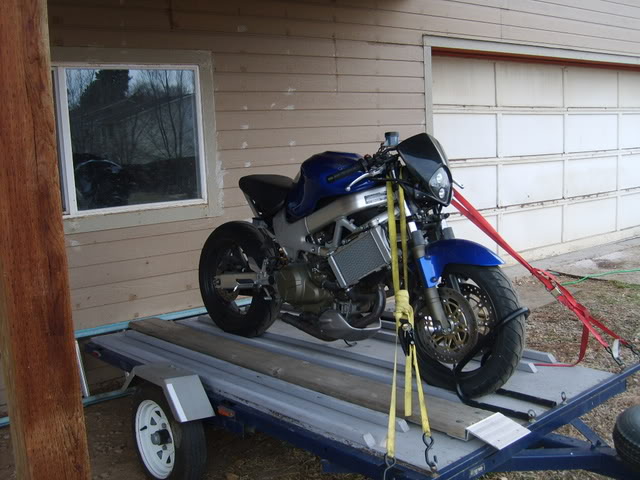

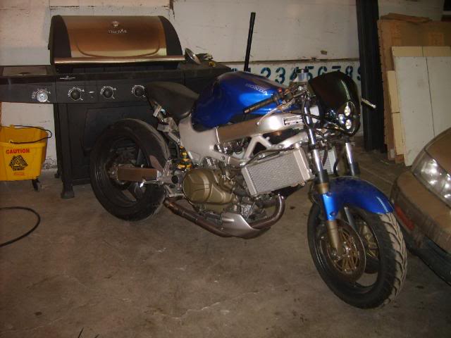

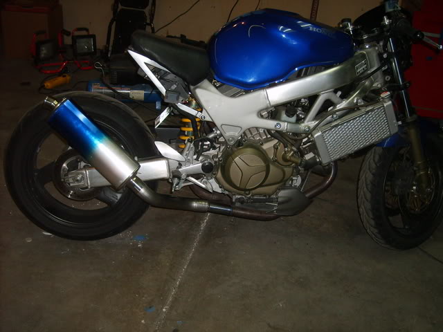

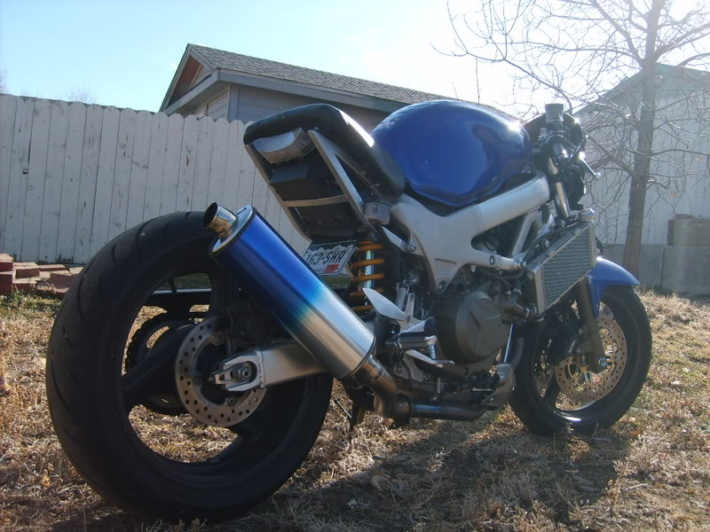

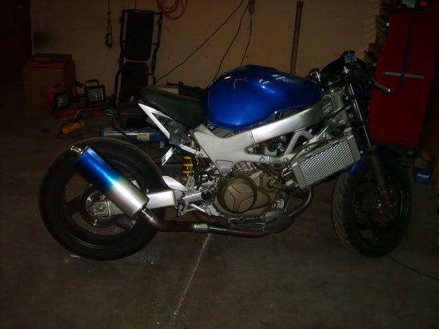

So this is my first post, thought i would start out with a bang and show off my ride in its current state.
its still a work in progress obviously im waiting on my can, tail light, gauges and a rear hugger then paint

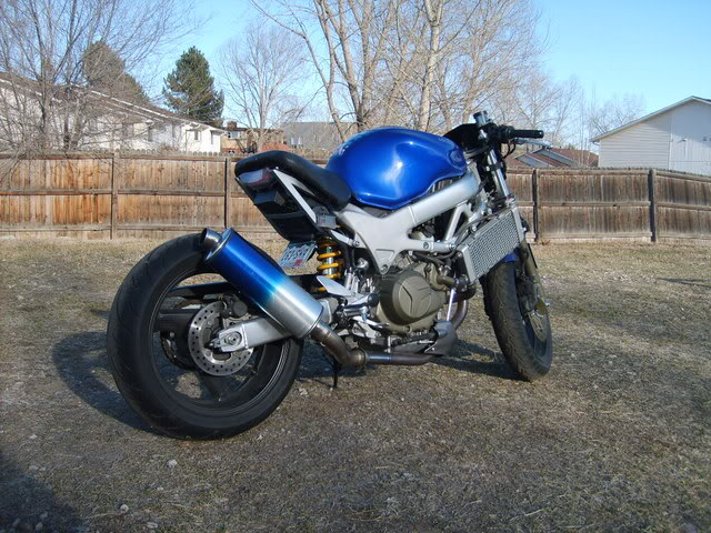

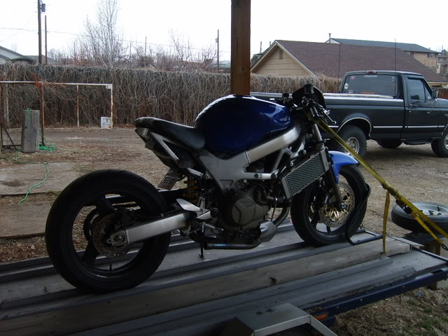

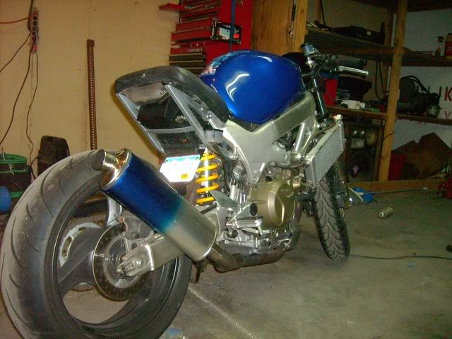

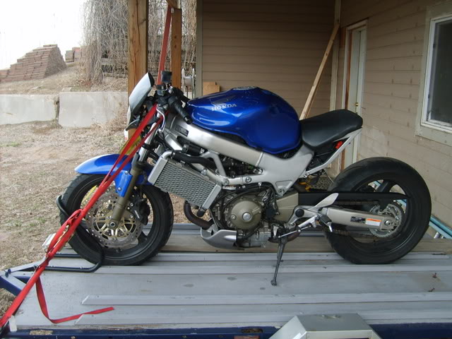

new pics yesterday before i made it to the exhaust shop

looks killer !!
Old Feb 16, 2009 | 07:59 PM
That rear end looks ******' crazy I love it! Look up the Sachs Beast for inspiration if you don't already know of it.
Old Feb 17, 2009 | 12:15 PM
LineArrayNut's Avatar
I could ride in
Posts: 1,729
From: Dayton, TN
you sure yer *** isn't gonna slide offa that bobber?
Old Feb 17, 2009 | 04:15 PM
AMF Racing's Avatar
Posts: 61
From: New Jersey
AMF Racing
sick man, hows the exhaust gonna be run?
Old Feb 17, 2009 | 05:02 PM
fighter hawk's Avatar
chopped and screwed
Posts: 41
From: Denver
fighter hawk is on a distinguished road
Ive ridden it a couple time just straight piped like it is now and falling off isnt gonna be a problem, i increased the angle of the subframe and i cant keep my ***** out of the tank now.

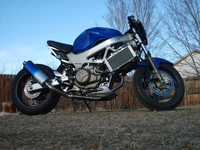

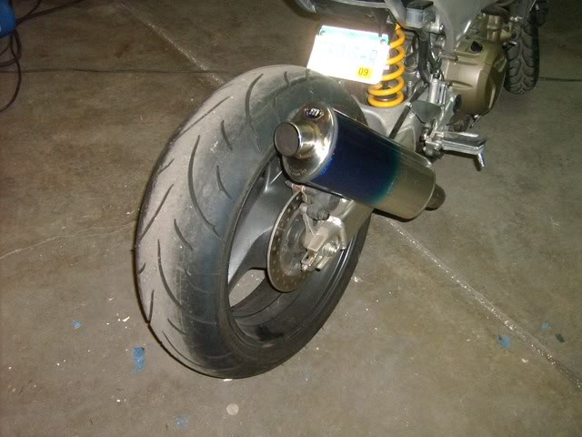

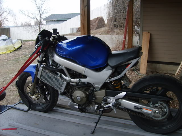

i got exhaust>

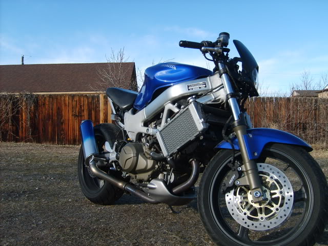

so what does everyone think? she's done for the time being, I thrashed her good today and got a lot of stares, im assuming people were wondering what i was riding, but i just think to myself that its the result of loving the hawk but not wanting to pull up to a stop light and seeing another like mine. ever!!!

That thing is SICK! I love the exhaust pipe coloring and the way it matches up with the rest of the bike (what's there anyway!). How's it sound with the single pipe? Can't quite see how the collector is set up underneath to run them both together...
Oh, and PM sent about some parts...
Old Feb 19, 2009 | 06:12 PM
skoshere's Avatar
Posts: 388
From: Muskego,WI
looks good, i really like the front
Old Feb 19, 2009 | 06:40 PM
chopped and screwed
Posts: 41
From: Denver
It sounds mean i love the note. Its a micron pipe thats been shortened 5 inches, its a real deep growl at idle and pops under deceleration. and the stock exhaust is a two into one into two so i just chopped it at the y and got a really good local hot rod shop to mandrel bend up a piece of 2 inch stainless and sleeve the stock y pipe.

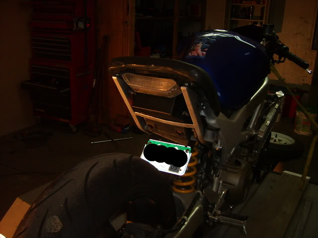

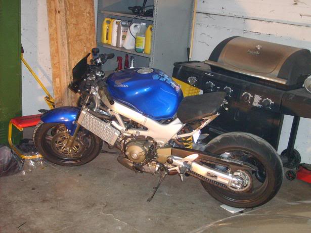

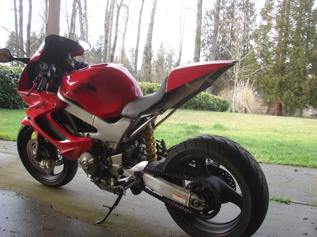

I'M DOING A SIMILAR THING WITH ME BIKE I'M WOUNDERING WHERE YOU HID THE COMPUTER CHIP'S LOOK'S LIKE YOUR BATTERY STAYED I CAN'T PULL THAT ONE OFF

Both those bikes look nice. I especially like the red one, but I'm partial to red.
I just never like the side radiators on a streetfightered Hawk. They stand out too much for me, but if you like it that's really all that matters.

I hid what i could fit between the frame rails and the battery moved forward almost to the shock i built a housing behind the battery to hold the ecu.
with your bike you have alot of room behind your plastics to hide stuff you may have to add some wire to make your harness long enough though.
