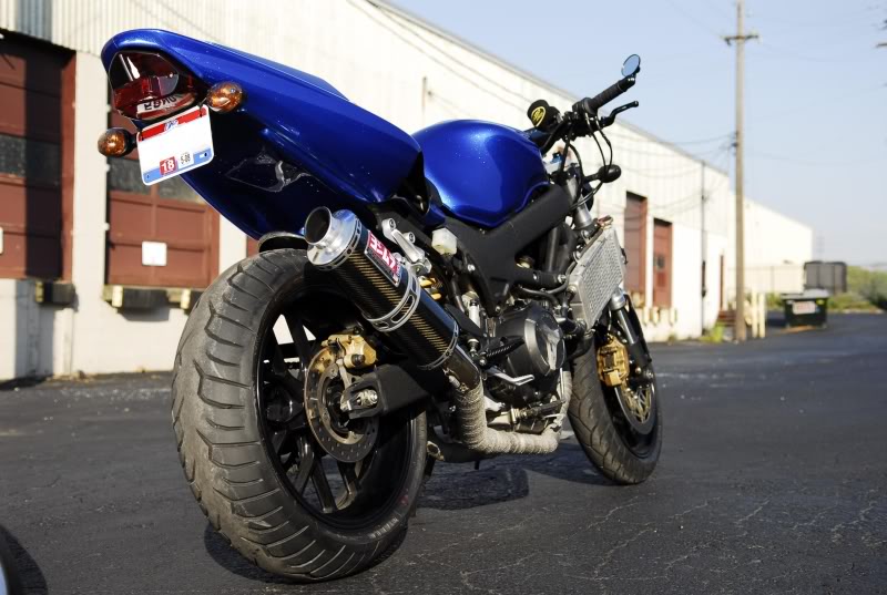

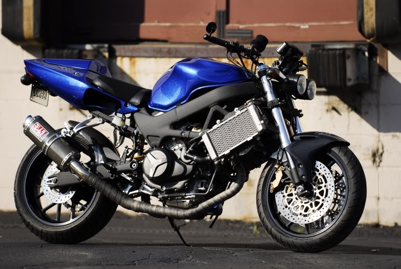

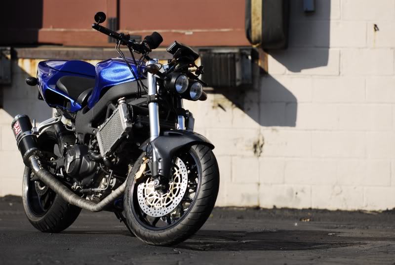

This is my first 'fighter. I've been working on it for about two years. It used to be a 1999 Honda VTR1000F Super Hawk. I have fabricated, modified, or replaced everything but the engine internals. Maybe some day I'll have the time to sit down and list everything I've done. Let me know what you think. Enjoy!!

Is this a for sale ad? :P Listing all the details would help immensely. Otherwise, $6500 is a lot to ask with no details.
Nice lookin' paintjob. The wheels are sweet too.

Alright..... You asked for it..... The List!!
996cc 90 degree Aluminum V-Twin Engine
PAIR System Delete- Custom SSA Block-Off Plates
Carburetor Coolant By-Pass
19L Fuel Tank- Custom John Gavula Paint
Aluminum Frame- Wrinkle Black Powder Coat
Aluminum Peg Mounts- Wrinkle Black Powder Coat
Aluminum Swing Arm- Wrinkle Black Powder Coat
Clutch Master Cylinder
Speigler Performance SS Braided Clutch Hose
Rear Brake Master Cylinder
Speigler Performance SS Braided Brake Hose
Rear Axle
Rear Brake Caliper
Pazzo Shorty Lever
Modified Factory Header
Unknown Aftermarket Clutch
Rear Forged Aluminum Carrozzeria V6 Wheel- Black Anodized
K&N Air Fliter
Carbon Fiber Hugger
Steel 520 15t Front Sprocket
2003 Honda CBR954RR
Lower Triple Tree Clamp- Wrinkle Black Powder Coat
Inverted forks
Front Axle
Front Brake Rotors
Front Brake Calipers
Front Brake Master Cylinder
Pazzo Shorty Lever
LSL Super Bike Handle Bar
LSL Super Bike Upper Triple Tree Clamp
Speigler Performance SS Braided Brake Hoses
Front Forged Aluminum Carrozzeria V6 Wheel- Black Anodized
2001 Suzuki GSX-R750
Aluminum Tail Sub-Frame- Wrinkle Black Powder Coat
Aluminum Rear Pegs and Mounts
Rider Gel Seat
Tail Fairing- Custom John Gavula Paint
Rear Seat Cowl- Custom John Gavula Paint
Battery Tray
Tail Light
Fiberglass Under Tail- Custom John Gavula Paint- Custom
SSA Plate Bracket
Custom SSA Electrical Mounts
2004 Honda RC-51
LCD Instrument Cluster- Custom SSA Bracket
2003 Kawasaki ZX9R
Yoshimura Carbon Fiber Muffler w/ modified mid-pipe
2006 Kawasaki ZX6R
Vortex 520 43t Rear Sprocket
2006 Honda CBR1000RR
Front Carbon Fiber Fender
2006 Buell XB12
Front and Rear Turn Signals
Others
RK Racing 520 Chain
Oberon Bar End Mirrors
Aztec8 Dual Four Inch Headlight Kit
Pirelli Diablo Strada 120/180 Tires
I Think That’s It!!

The header was cut and a two inch section of pipe was added to the end of the collector. The exhaust is from an '03ish ZX9R. I shorted the muffler to 13 inches and only modified the the mid-pipe slightly. The system is still a slip-on.
The hugger is a Pyramid carbon I bought used off of someone on here. Sorry I can't remember who, it's been too long.
