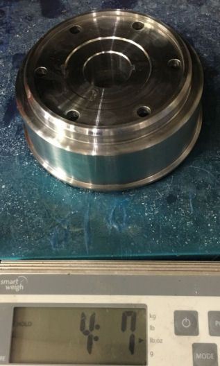

Old Nov 29, 2017 | 03:26 PM
  #155

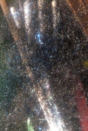

Target weight was "about 5 lb" as rider wanted a "not your lightest version" I weighed swarf as it came off the flywheel for a guesstimate on what i had removed and got close...
Finished weight is 4 lb 12 oz
This one drew blood .......... think of it as razor sharp confetti
Attached Thumbnails Flywheel Lightening-done-4-12.jpg   Flywheel Lightening-swarf.jpg

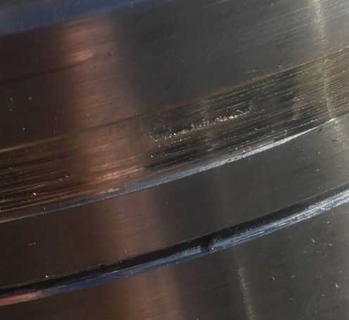

  #156
Yesterday I found an interesting and new issue..
I cut the basket of one yesterday to my standard 135mm diameter ..And found the area of the basket that is "stamped" actually caused the steel to fracture and once the deformed steel was cut away, the fracture reveled itself.
The fracture you see was visible at 138mm which is the diameter of the area on this one that is smooth and finished cut. After finding the fracture I did a rough cut to 133mm just to confirm it was a fracture and not just a scratch from dragging a tool across the surface. You can clearly see the fracture in that pic.
At first I thought I had cut too far and it was undersized..but no...the dia was 135.43 mm so almost 1/2mm above my general target..
This is the first time I have seen this issue and I cut two more last night to confirm it was not something "new" I was causing .
The next flywheel i cut at 139mm looked like this the deformed stamping is still just visible.
At 138mm its gone and you can just see a shadow of where it was
So just another item to inspect on a provided or bought flywheel that might make it junk for this MOD ...like the ones I get from ebay that were removed with a 3 jaw puller, or the key way / taper is damaged... flywheel has been dropped and the basket is deformed. 1 in 4 flywheels i look at on ebay are rejected for purchase because of these type of issues and I've been burned a few times still with what shows up.
So look well before you purchase and if your doing this MOD be on the look out when you cut it down for these fractures..... I found them at all stamping locations on that one flywheel..

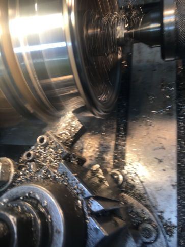

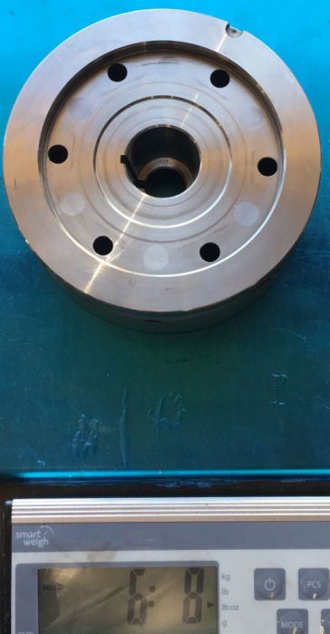

Was asked to do a Moriwaki cut on a flywheel this week..not something I normally do anymore, but as I was already set up for flywheels this week it was an easy deal to knock out.
I was a little surprised at how little weight it removed.
Started at 7lb 3 oz
Removing 0.50" of OD from the weight disk only finished at 6 lb 8 oz
Reduced by 11 oz
Its what the rider feels works best for his riding style, and I cant fault that, we all ride differently, and what "feels" best for one is not the same as for another.

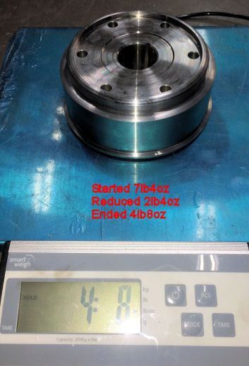

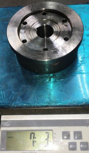

Old Feb 21, 2018 | 12:04 PM
  #168
Another flywheel went on a diet

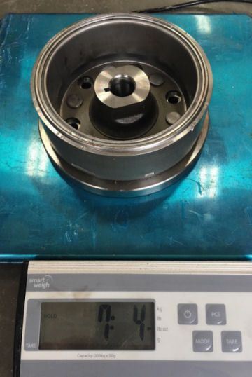

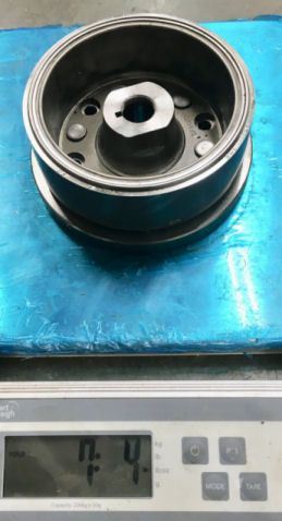

Starting at a porky 7 lb 4 oz
She got a trim and a hair cut
Ending at 4lb 8 oz
Reduced by 2lb 12 oz
Attached Thumbnails Flywheel Lightening-before-7_4.jpg   Flywheel Lightening-ending-4_8.jpg

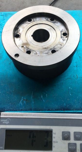

Old Mar 25, 2018 | 06:21 PM
  #171
Another flywheel went on a diet today.
Started at 7lb 3oz
Tried the world famous Texas cutting diet, know to shave pounds off your middle
And finished at 4lb 7oz

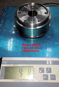

And another
Started at 7lb 4oz
Ended at
Off it goes to a fellow rider.

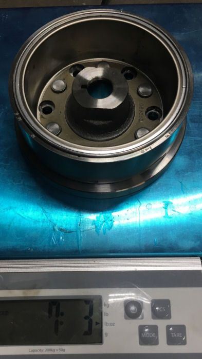

Wait what...is that another 4lb flywheel???
Why yes it is..
Starting at a porky 7lb 3 oz
Ending at 4lb 7 oz
