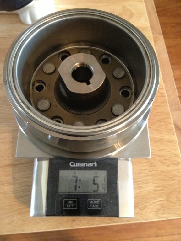

Weighing in at 7lb 5 1/4oz we have flywheel number 15 weighed and ready to go under the knife.
Full weight reduction was requested.
The flywheel weight will be reduced to 10.5mm wide x 142mm or so.. should come in at 6lb and some change....

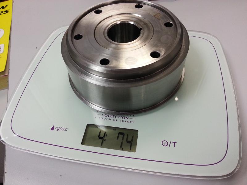

Have you seen
gl_s_r i's effort? (hope it was OK to share Mark!)

Thanks I have not seen that work.. nice.
I did one that far, but have not let it out of my hands yet...
Cutting that much in to the weight AND cutting the basket is a big unknown.... it is not a recommended MOD by any of the guys that were doing this for race bikes back in the day...
My way of thinking is/.... The Roger Ditchfield's and like, did not stop cutting on the flywheels when they reached the level of materiel removal they did for lack of a machine capability or skill... they choose to not cut on the basket, and they choose not to cut the weight as you see in that attached pic above....
Not knowing why, I prefer to stick with a cut and weight reduction that is tried and true... at least on flywheels I send out the door for others.
I will install my light one on my own bike this summer and see if it holds up.

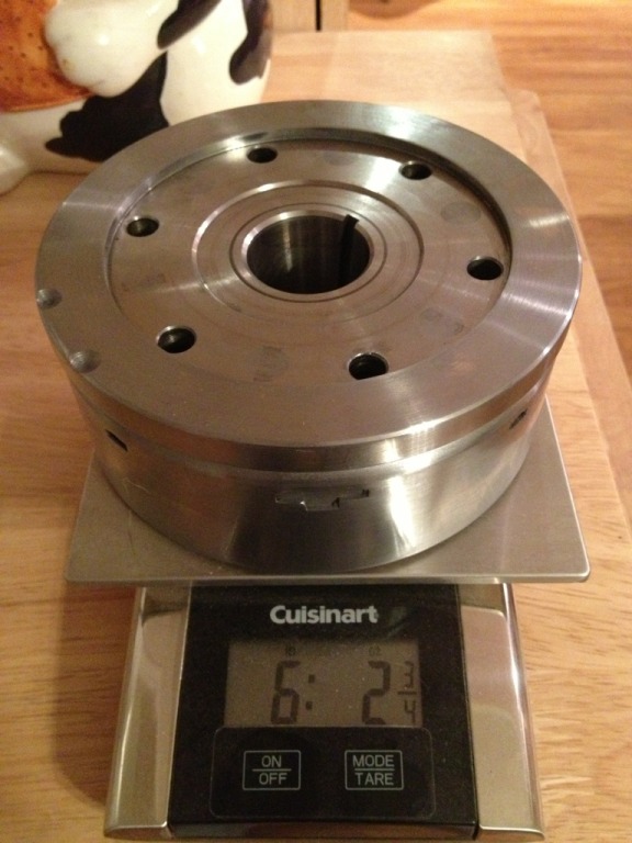

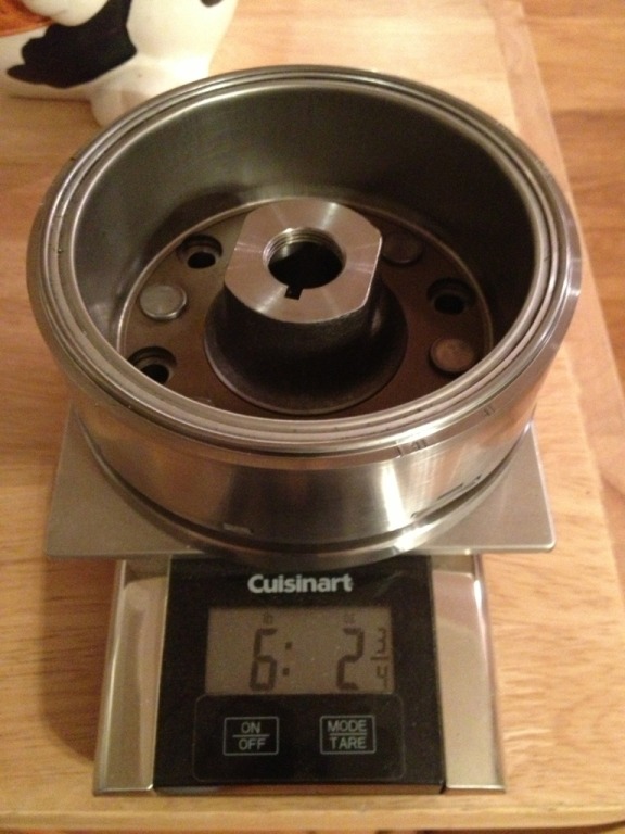

Old Mar 21, 2013 | 08:00 PM
And for this one, we ended up at 6lb 2 3/4 oz
for a reduction of 1lb 2 1/2oz
The basket on this one was slightly out of round, so I took a .002 skim cut then polished it some to true it up and reduce the stress risers from cutting.
