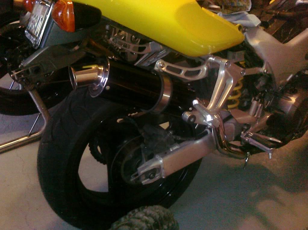

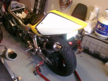

here are a copy cell phone shots of my setup, when i get the back home ill get some better pics but this will give you an idea.
with the stock tail

with the gixxer tail, yes its gonna get painted
