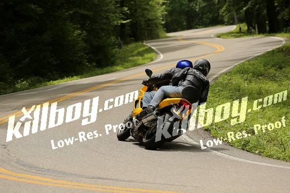

Proper air pressure... AS recommended by Honda.. 36/42.. ONLY if you are going to be really pushing(really carving curves) Then 32/40...Yet as noted by prior post... Under pressure/ or Over pressure does change geometry of the bike suspension....
Wife, and I riding Hwy129 on 2001 S-Hawk with (suspension tuned/ GMDcomputrack) riding 36/42psi on 120/70/17, 190/55/17 tires

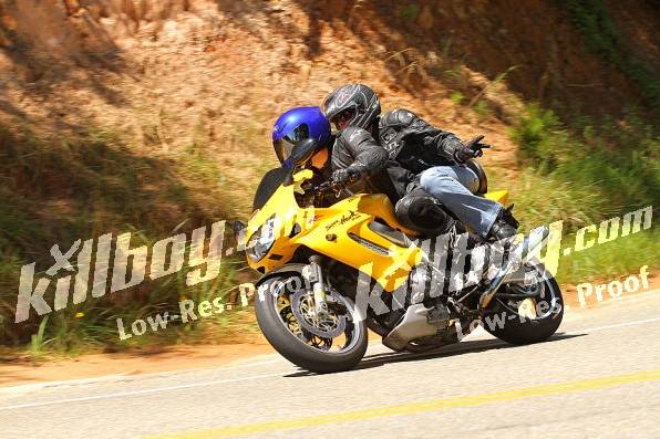

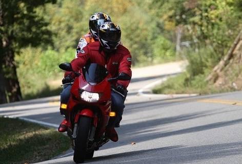

I concur, although I run a standard 180 rear and a 2k Hawk.
Name:  PowerheadProductions-killboycomatPhotoReflectcom-DealsGap-Monday-July292013-killboycom_.jpg
Name:  PowerheadProductions-killboycomatPhotoReflectcom-DealsGap-Tuesday-July302013-killboycom.jpg

Nice man. Surprised how well the bike handles 2 up.
