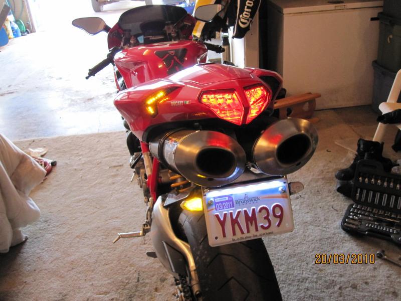

Old Apr 17, 2010 | 05:13 AM
finepooch's Avatar
Posts: 1,269
From: moncton nb canada
http://luckybike.com/lighting-stalk-...cdc5973b5f3d9c
i felt the vent lights that came on my 1098 weren't enough so i added the plate lights.

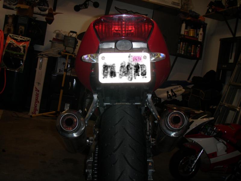

Old Apr 22, 2010 | 06:40 PM
deiss44's Avatar
racer44
Posts: 18
From: Illinois
deiss44 is on a distinguished road
fender eliminator
A couple of giys wanted to see my fender eliminator. I redid it today and got rid of all reflectors and moved the key under the fender for the seat. I hacked aways at the fender and replaced all with stainless steel after cutting a price 11" wide and narrowing it to 7" at the back. I used a sheet metal brake and bent the angles for a perfect fit to the underside of the seat. I then made a bracket for the signals I bought from wolverine that looked a little better than the aftermarket one that the purchase came with. Tell me what you guys think.
