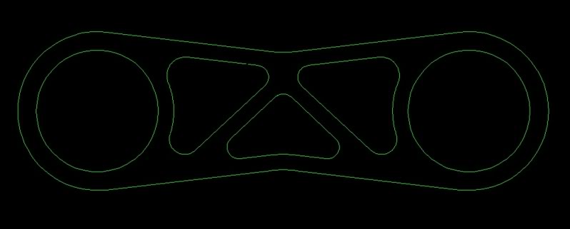

I should have a screen shot with dimensions of the brace later tonight If you wanna test it.

PM me when you get it ready and we can discuss what all you need from the FEA (ie type of analysis, what you're looking for like safety factor, weight savings, structural rigidity, etc). I will also need to know the boundary conditions you want to run on it (forces/loads applied and where).

its getting there
final design
Size:  19.1 KB[/QUOTE]
What you people think? I like the way it looks

looks good.

as you can see the stock fork boots can be re used. They only slide down about half as far as stock, but a few dabs of silicone should hold them in place just fine.

Dont forget to radius the corners of the top and bottom surfaces
Old Apr 16, 2009 | 08:00 PM
  #102
Truckinduc's Avatar
Posts: 1,033
thats just a mockup blank to make sure the spacing is correct. Dont worry the edges will be smooth.

Do you just drive them onto the forks, or are you going with the slot and bolt 'clamp' like was drawn into your original sketch? Just looks like they need some way to secure them to the fork lowers other than just being driven on, considering the flex involved.

Originally Posted by YellowBird
This is probably a dumb question but, does the install require fork removal?
No, not dumb at all... Yes, since they are smaller than the thick lower leg you will have to drop the fork legs out of the triples to install them... That takes a stand that lifts in the triple or creative use of a beam and some straps...
actually no. Its a 3 piece design. The outer pieces clamp around the fork legs and to the center brace.
There is no dis assembly required. About a 5 min install.

Truckinduc's Avatar
Posts: 1,033
correct, you DO NOT have to remove the forks.
You need to slide the stock fork protectors up, bolt up the brace, put a few dabs of silicone on the inside of the fork protectors, slide them back down, then go ride.
