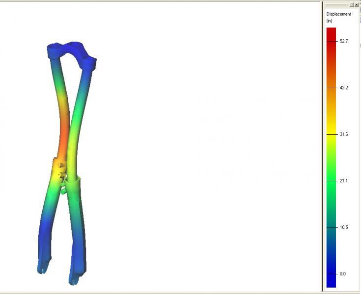

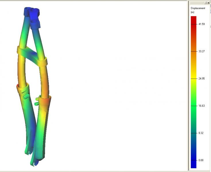

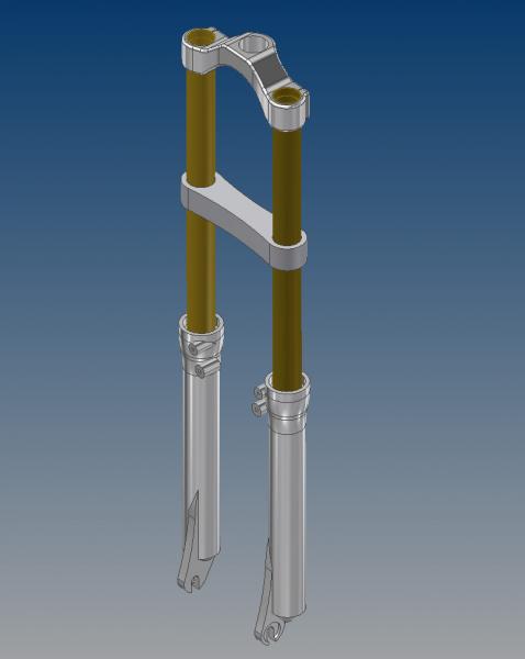

I mentioned earlier about running this thru FEA to verify design intentions. I played around a little today at work to see what a brace would do in a mock environment.
The brace does work depending on the load direction being applied.
I ran my setup thru a frequency test to see the displacement values on the assembly with and without a brace added. As you can se in the right panel, it does help with displacement. These tests could of been conducted in a force application rather than frequency to get a better idea of the effects. But using a frequency I'm able to get a off the cuff idea of it it does anything or not. In short it helps in rigidity but to what extent...I wouldn't know without know all the parameters of the assembly (dimensions, materials, load values, etc). In this test the brace helps by roughly 9 inches of displacement given the conditions I applied to this FEA test. Obviously these results are exagerated as I do not know the dimensions and everything but it does show it helps with rigidity. To get a good idea of actual performance of the brace it would need to be run under multiple FEA runs and under various loads and directions.
See attachments...
Attached Thumbnails TMBmotorsports forkbrace????-suspension.jpg   TMBmotorsports forkbrace????-feawithbrace.jpg   TMBmotorsports forkbrace????-feawithoutbrace.jpg

The brace actually goes closer to the middle, atop the lower sliders, where its effect would be even more significant.

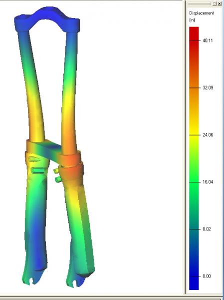

Fixed
Also I forgot to mention these results vary in range from 400Hz-485Hz.

noticeably better I'd say.....

Originally Posted by haknslash
Fixed
dam! you'd think that this much deflection would be be cracking the fender, wouldn't ya?
You'd be removing fillings in your teeth for sure . I think the scale of those is also around 1/400 . 1:1 would blow them apart.

Nice FEA, Inventor?
What happens when you include the fender?
What are your boundary conditions?
Are the upper and lower fork components coupled?
M
