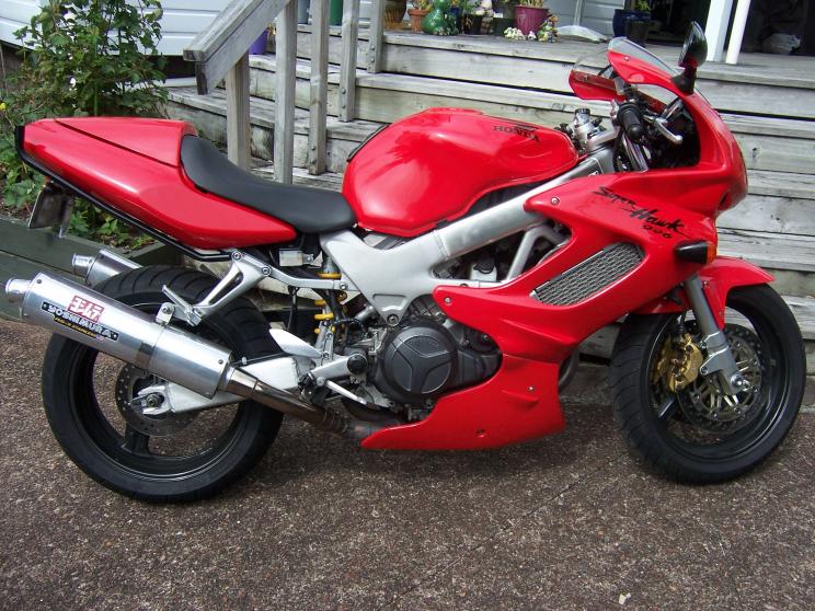

Hi All.
I just bought a 98 SuperHawk, which is strange as they were never sold here. It came into NZ in 06. We do have Firestorms which is the same but a little different. I got it at the start of the week cheap as it needed some work. Shes got 26000 miles on her and in good shape with Yoshi RS3s (and DB Killers, canr get them out).
So far I have fitted Gold Valves, .95 fork springs, pair removal, new throttle cables, -1 on the front and fixed various other problems.
Had my first ride on it today. I love it. Im coming from a Honda 919 which is a stonking bike but boring.
Couple of questions, when down changing im finding blipping the throttle is not getting the motor spinning. Im wondering if my jetting is out so a blip is not doing much. I have read a carb thread on here which says you need a special tool to adjust the pilot screws, is this correct?
No the way home I noticed it was handling a bit off. When home I lifted her up and it seems the head bearings are shot. New bearings on order.

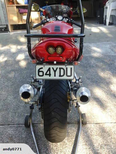

It also has a custom under tail, does anybody know who made it?
