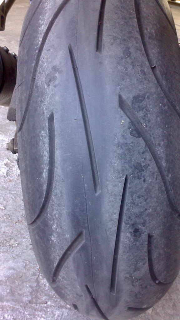

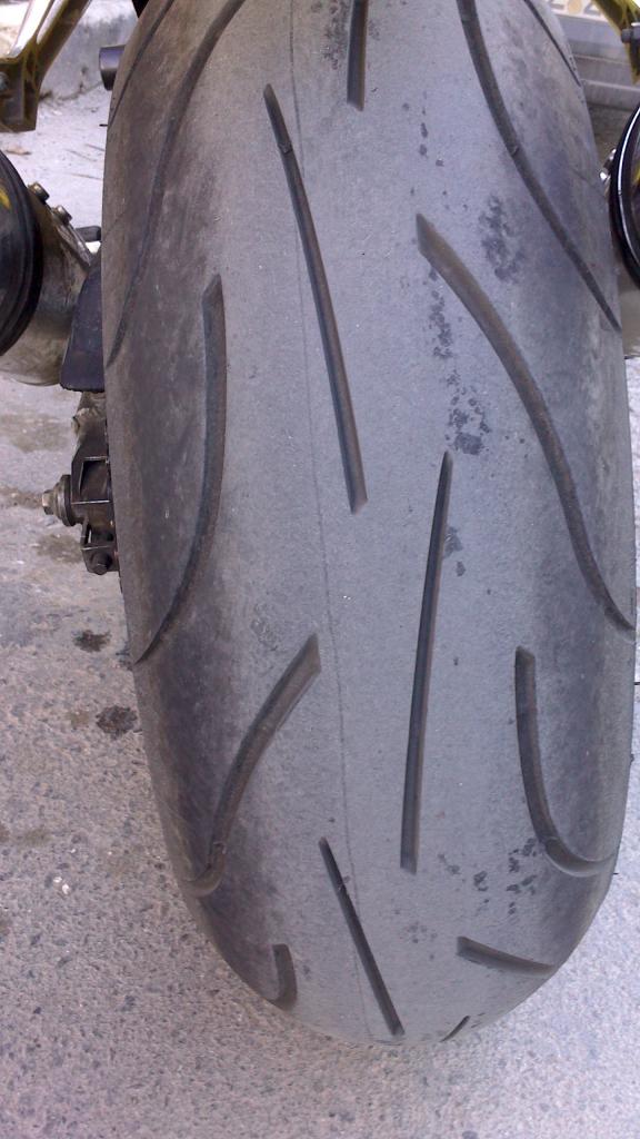

Ok here's my issue, and sorry if the section is wrong, but I thought it might not be much "technical" after all.
I noticed this weird line on my rear tire. I'm kinda worried that it might split in half at some point, can someone tell me what it might be? Tires are new, 5 months old.
It appeared like out of nowhere and got me thinking. Will I die? HALP

Old Jan 9, 2014 | 04:45 AM
Wicky's Avatar
Posts: 1,707
From: Essex, UK
Strange line scored into tire, what is it?

Old Jan 9, 2014 | 02:20 PM
A friend and I both run BT-023 rears, they have that line as well.

Good to know. I looked at my tire and yes it also does have it. A nice sigh of relief is in order. I thought someone was messing with me.
Old Feb 20, 2014 | 09:05 PM
Posts: 2,098
Just read about this in the April issue of Motorcyclist. They say it's called "antenna tread" and that it is a section of tread devoid of silica in order to dissipate static electricity. Shocking.
