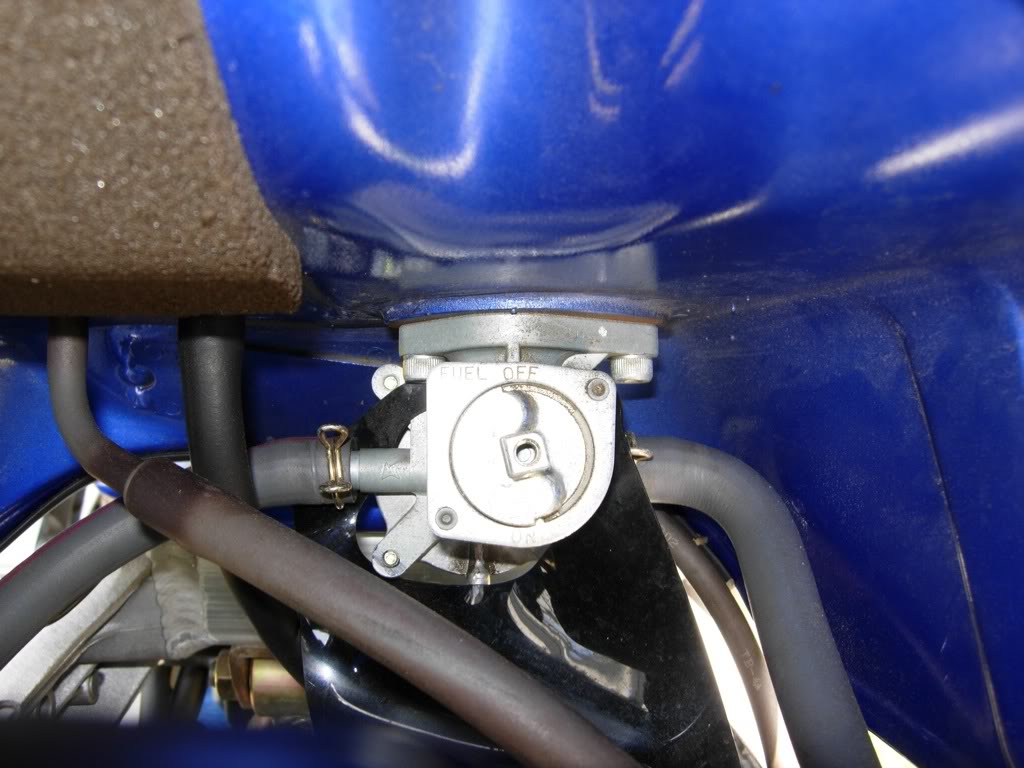

Old Feb 5, 2009 | 05:00 PM
drew_c14's Avatar
Posts: 2,455
From: Williamsburg, VA
this is what it should look like
front looking back
from the back

... Success! It was a vacum line misplacement issue! Thanks to all!
