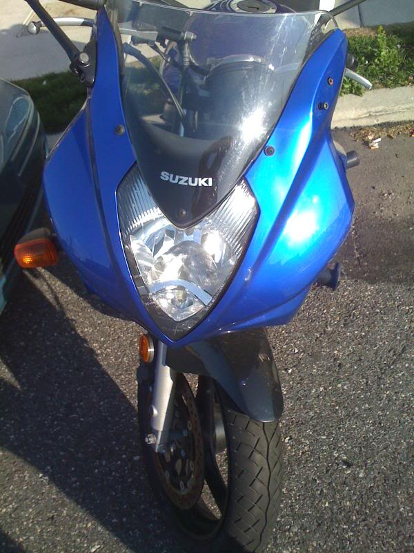

So I constantly see this bike sitting out side of this house near me, snow/rain uncovered. I drove by and left my number. SHE called me and I asked if she was looking to sell it. She said yes for $1,000 But she said she would drop the price for the bike as is. It was dropped and needs some parts but would be perfect for a Fighter! What would you buy it for judging by the pictures that I posted? Does it have 2,624 miles or 26,241?
Would $700 be a smack in the face?

Old Apr 26, 2011 | 11:12 PM
I'd be all over that, even at $1k. Only 2,600 miles too. Buy it, polish it up and sell it for $2,000!

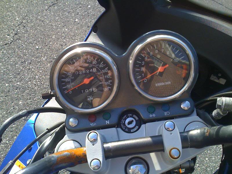

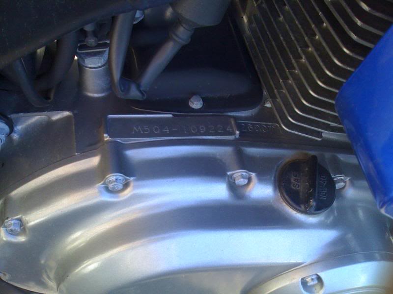

I'm still thinking does it have 2,624 miles or 26,241?
I am hoping it's 2,624 miles.
Old Apr 27, 2011 | 11:00 AM
Stevebis1's Avatar
Posts: 805
From: Delmar NY
Remember you can always raise your offer, but you can't lower it. Go in at $700, it seems she already gave you the opening to negotiate. Sounds like no mater what you got it for under $1000
Great find
BTW pretty certain it is 2,624 the last digit is 1/10

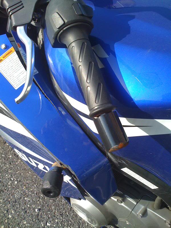

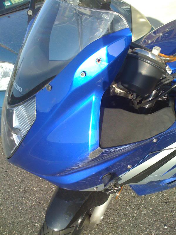

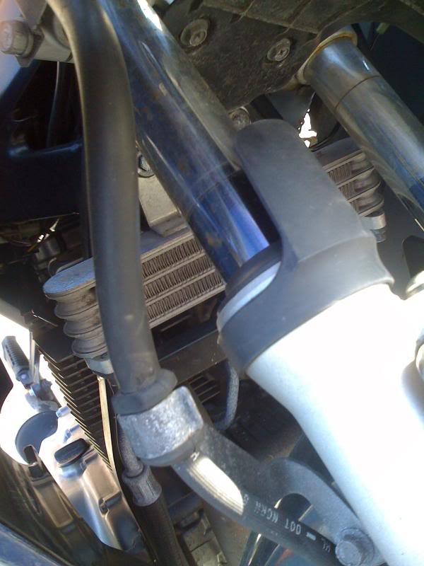

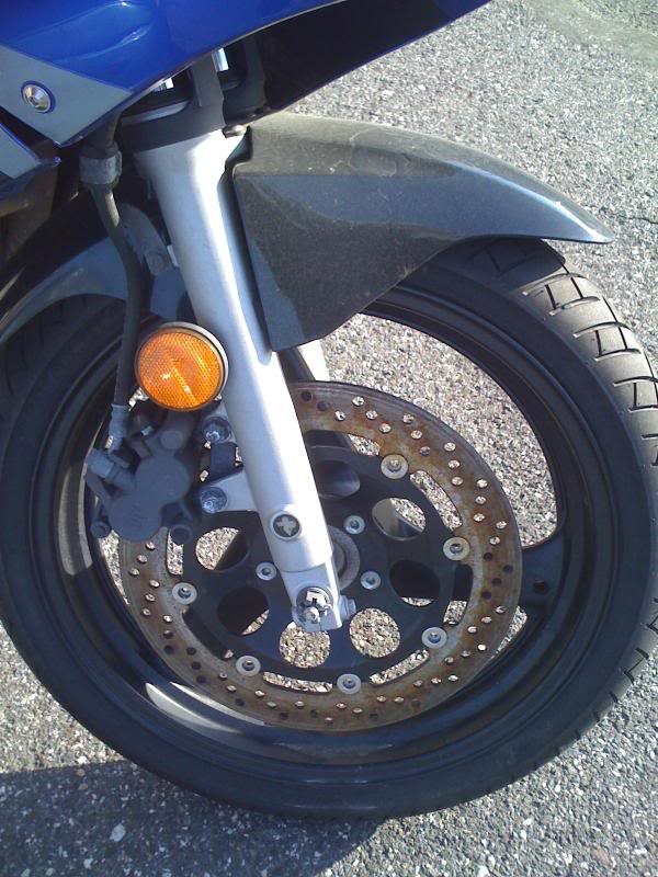

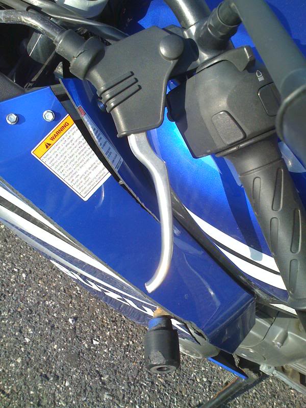

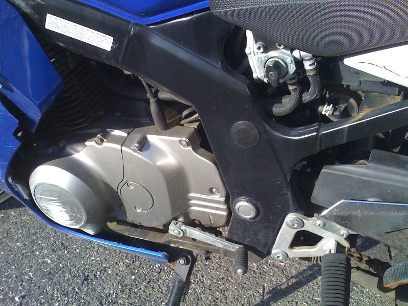

its 2,624.1 mi on the odo. It looks like it had a frame slider on the clutch side, (behind the turn signal) that is bent towards the back wheel. If it is, I would make sure that it is the bolt that is bent/broke and not the frame.

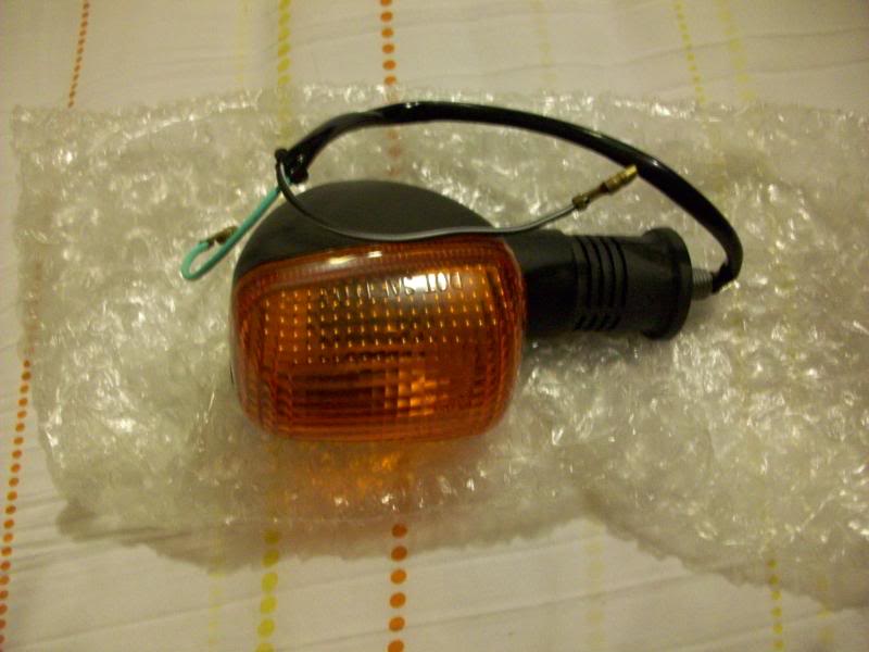

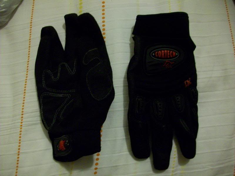

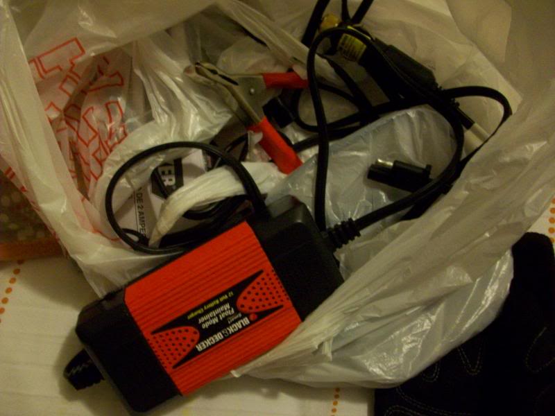

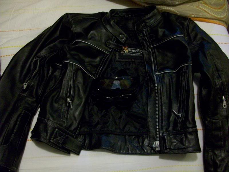

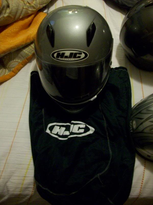

HELLO! So I met her in person today. After a little talking I asked what she would want, she said $600 She was the sweetest person!
She also included 3 helmets, Med leather jacket, gloves, 2 pairs of glasses, charger, new turn signal, new clutch leaver and a thor long sleeve shirt. I put a new charged battery in but nothing no click nothing.. What could it be?....Relay?....Solenoid?....Switch?....Fuse?.... Combo of all?... I popped the clutch it in second and started right up. She rides and brakes like new. I haven't checked 5th gear but others worked great!
I'm going to work on it tomorrow to get the starter working. I will update...
Here are some pictures of the gear.
New outlaw helmet all others are used

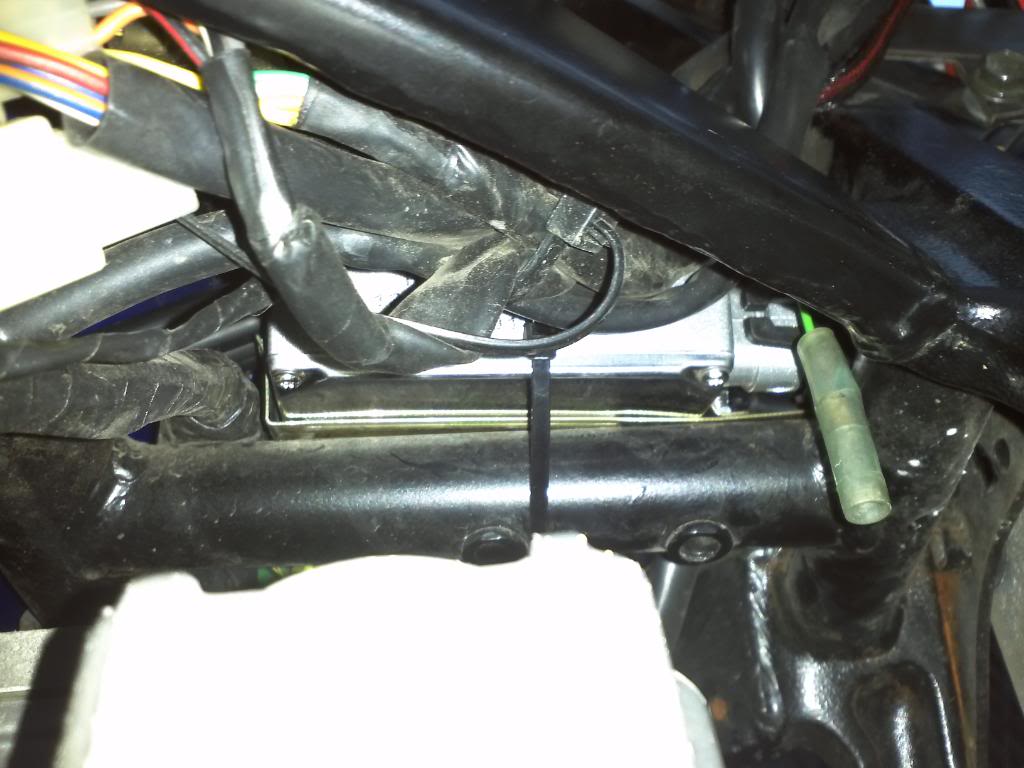

Ok so I sorted the starting issue with a multimeter. It was the clutch switch, when she dropped it it must have popped off track. I also charged the battery over night and it holds a charge. So no problems besides cosmetic.

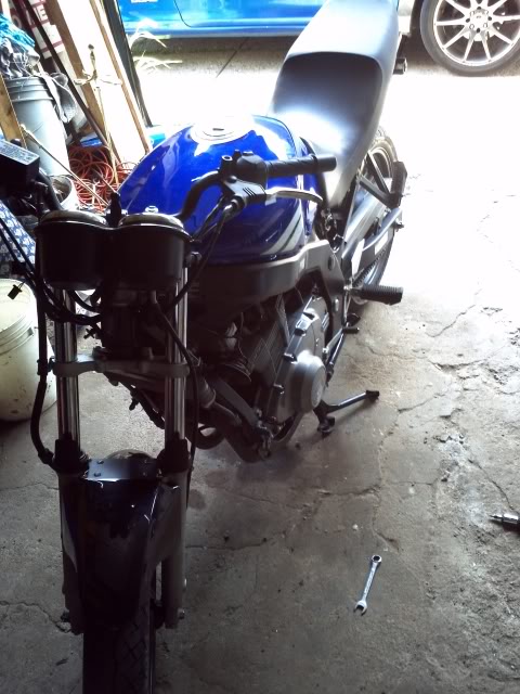

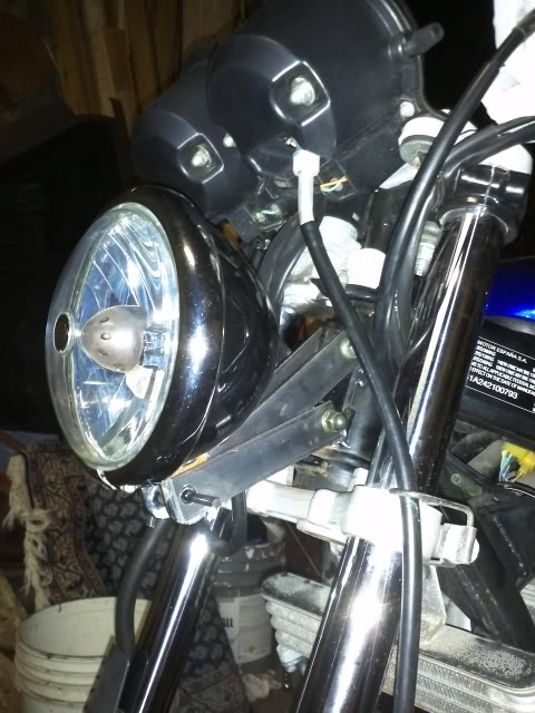

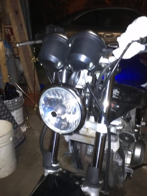

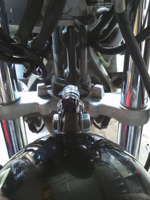

Hello!
It's been a while but I'm back.

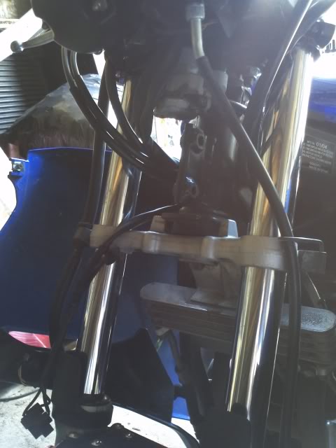

So today I got some work in on her.

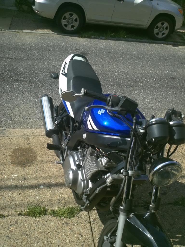

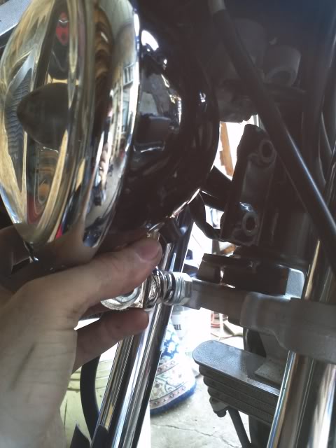

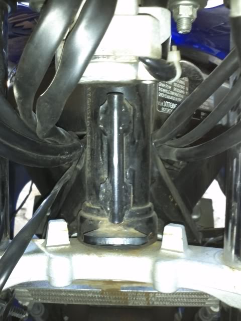

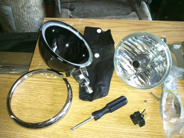

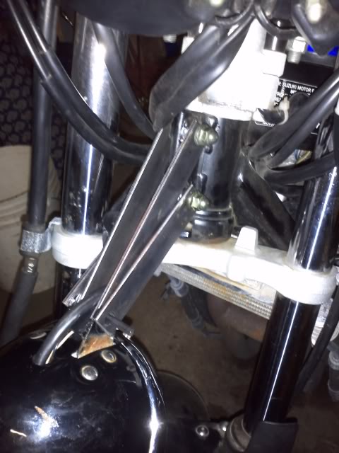

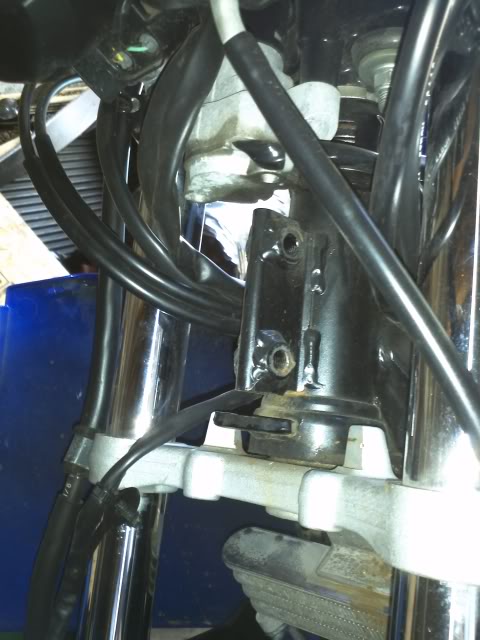

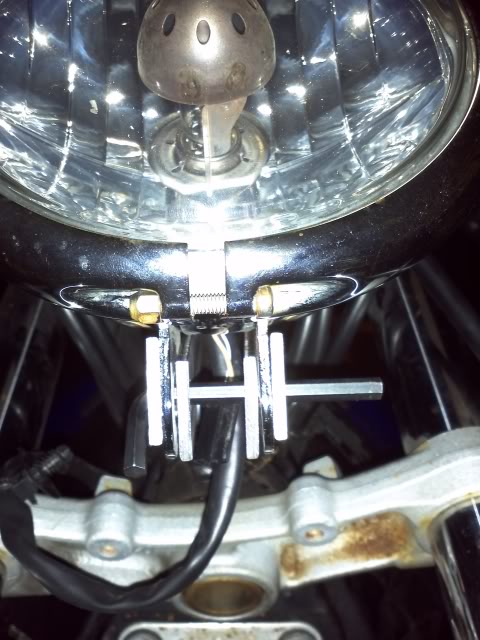

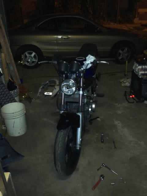

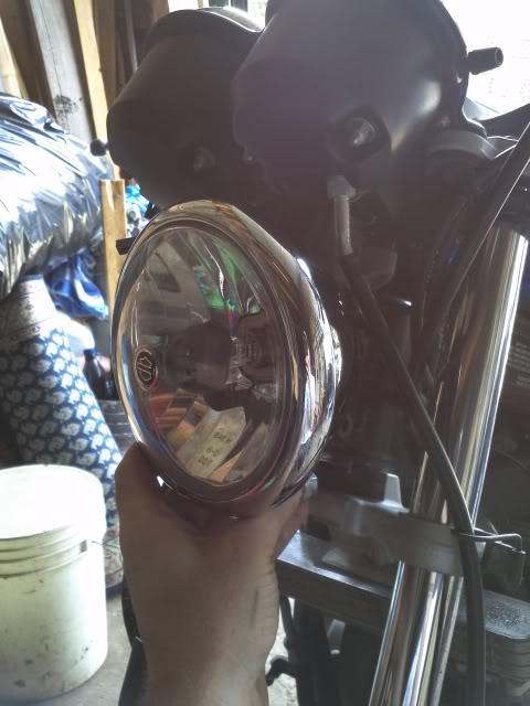

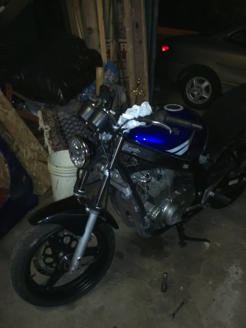

I got a 2007 Harley Davidson Dyna headlight and made a mock mounting bracket.
What do you guys think?
Size:  47.3 KBName:  dc7519f1.jpg
Perhaps some cutting, welding and paint after the fitment tomorrow.
Cost $5 for the steel from Home Depot 2x 6" - 2x 4 3/4" clamped together and drilled with plenty of oil.
I lucked out the bulb is a H4 the same as the gs500

I'd say you put it back to stock and sell it for a profit. Other than the light crash damage, that GS is pretty clean. They are excellent learner bikes, and good commuters, but not the ideal bike for a streetfighter project.

What I think is you SUCK for finding such a great deal! ;-)
I'm not a naked look guy, so I'd find a good bikini fairing or something like that.

You need to take a sharpie and color over that stupid harley davidson emblem. Otherwise it looks great!

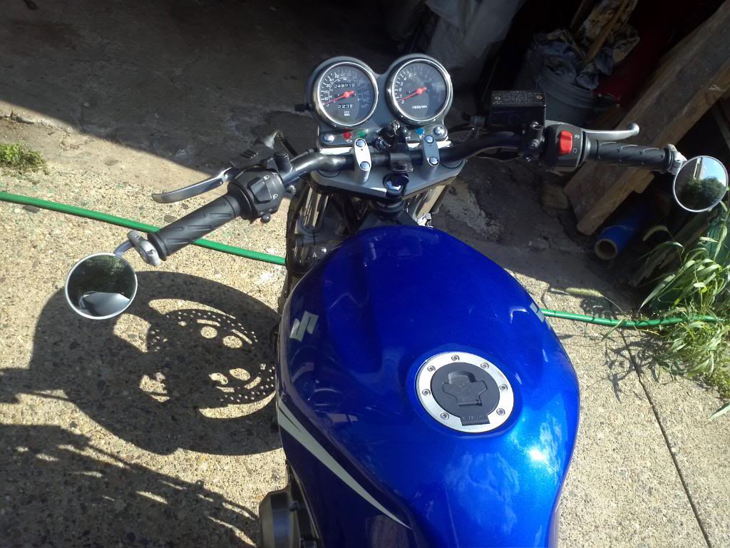

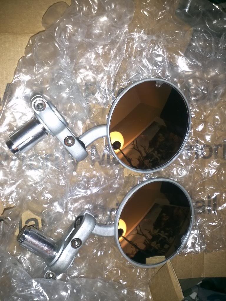

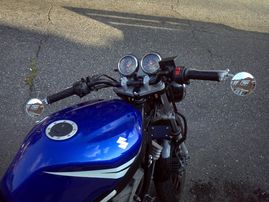

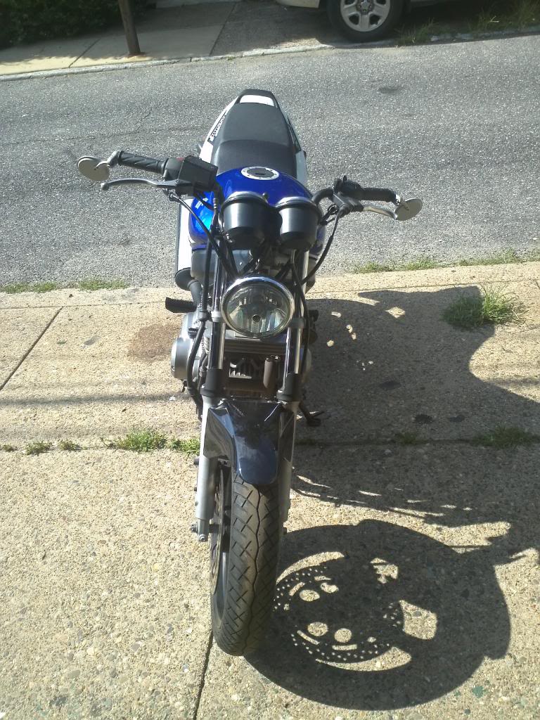

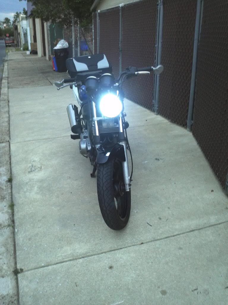

Hello,
Just an update I got bar end mirrors and 6000K HID. Let me know what you think.
HID
Video of HID
GS500F WITH HID Kit INSTALLED 6000K - YouTube
Video of the GS500F On the road
CRUISING ON THE SUZUKI GS500F & SOME RECKLESSNESS - YouTube
