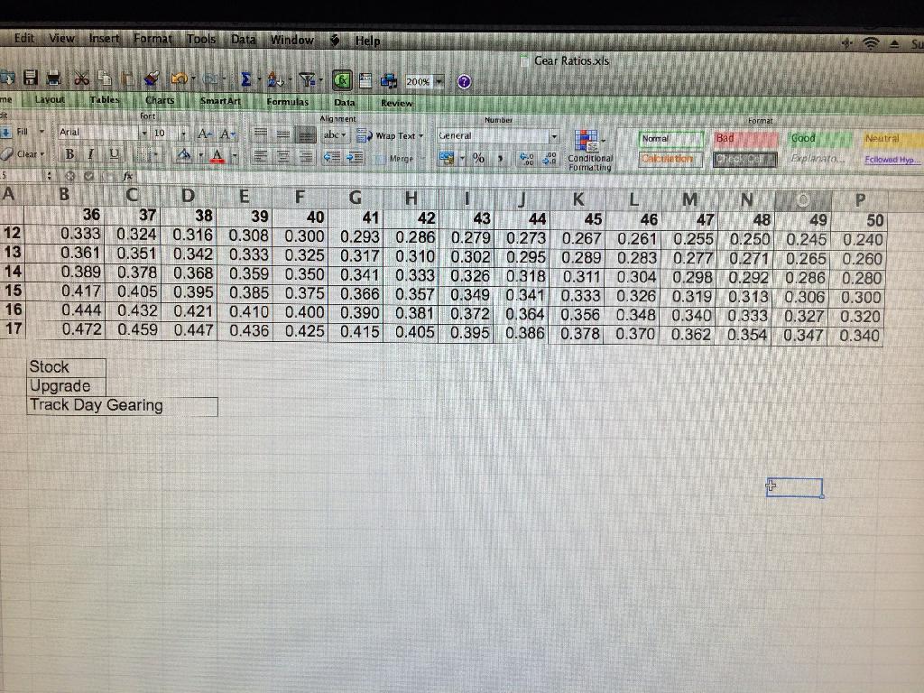

I ran a compact drivetrain on my cbr900rr. Managed to get the same ratio with smaller sprockets and less chain for less unsprung weight.
Gearing on the way! Compact Drivetrain!!
James
Old Dec 22, 2013 | 02:13 PM
thedeatons's Avatar
Joined: Feb 2013
Posts: 1,510
Here is a chart i used on my cbr900rr build. Find the ratio you want, then write that number down (.???). Try and find a number that closely matches that, but in a smaller sprocket set.
As long as they fit the bike, then it will work
James
