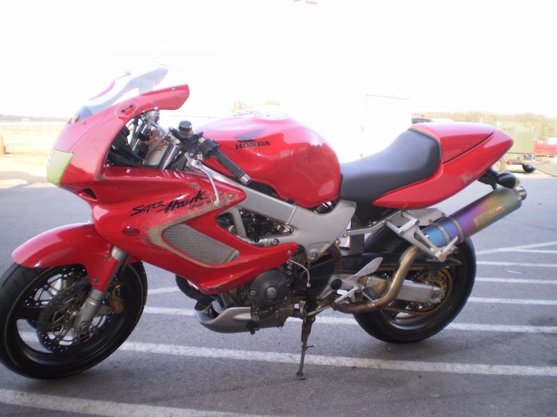

Haha, so my first track day was last friday at Summit main. Then Wed this week I went up to Thunderbolt raceway in NJ...First two sessions of the day were great, that track is awesome! The third session I asked a control rider to show me the lines a few laps, so he took me out with two people following me. The second lap I was coming out of a slow tight left, turn 5 I think, and I THINK that I came in hot and I was off the throttle through the begining of the turn then when transitioning into the throttle I may have grabbed a little too much too early while fully leaned over hanging off....rear tire spun and I was on my *** before I knew it...slid off the track over some gravel and into the grass...picked my bike up, it started fine, tires looked good, and rode back to the pits....The leathers did their job, I didn't have a scratch or bruise.
Luckily I was able to keep riding! My clutch lever was curled up and my shifter bent and half of the toe section broke off...I straightened them out and went through tech again, kept riding! yea!

Oh here is a picture of the damage...Not too bad really, could've been much worse.

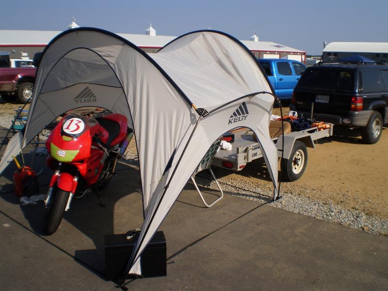

Earlier in the day
