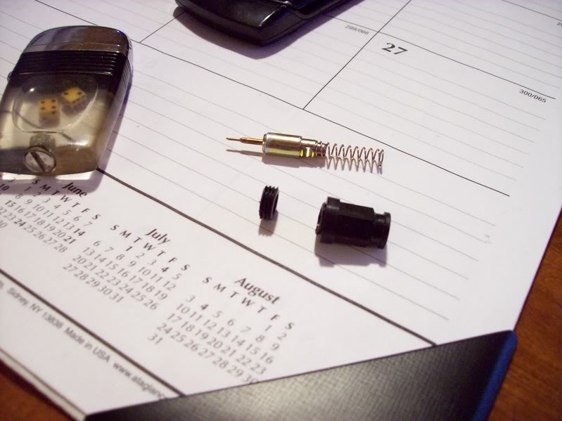

my day was not much better
lets play name that broken part!
(keeping in mind i'm new to this bike)
Judging by the hex shaped plastic thingy and the thread that was attached to it, along with the spring loaded do-dad ..... looks like someone ran into the problem i've been reading about lately - the dreaded "I broke the stupid plastic choke" issue.
May I inquire as to how you did this? I'd kinda like to learn from your mistake.
