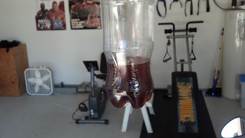

Just did my clutch fluid swap and bleed the other day. Was amazed how quick it gets dirty. Have clean fluid in the break reservoirs and am gonna bleed them tonight.
Here is what came out....YUCK!!!
PSA: Check your clutch fluid!-2012-02-28_15-59-42_396.jpg
