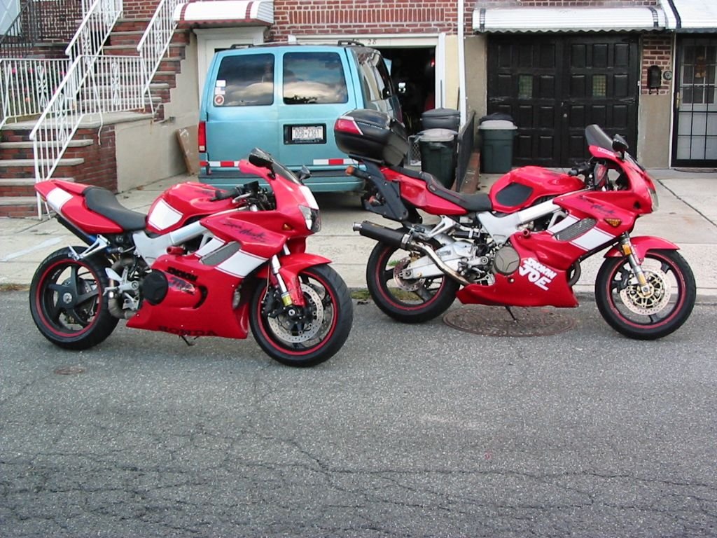

Yeah maybe I will transfer the 600RR dash onto the SSS bike and make that my primary. Would have to swap the GIVI setup too.
Old Jun 2, 2023 | 11:23 AM
Posts: 2,097

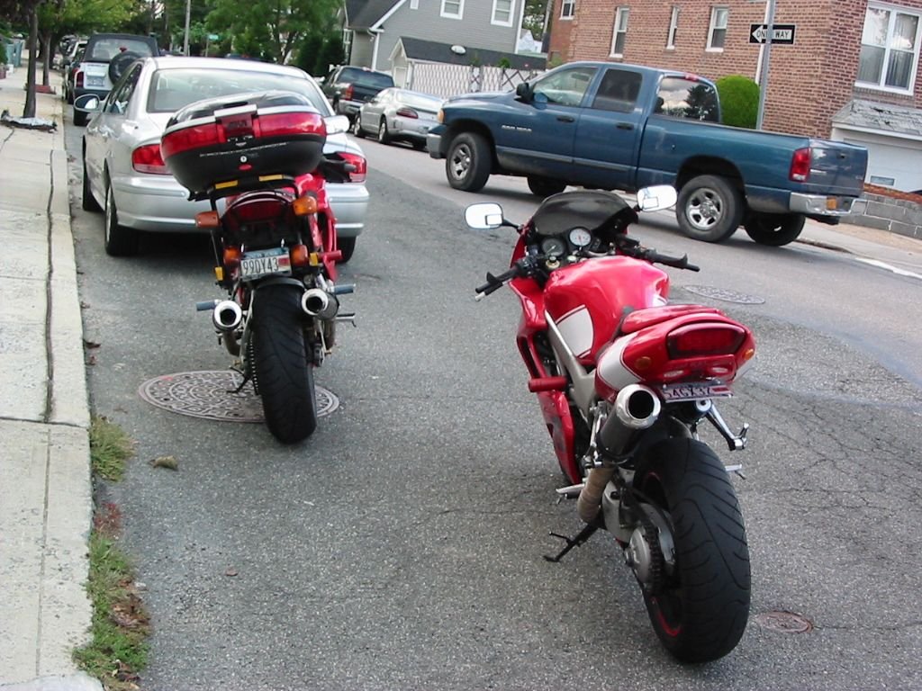

Just a thought, in fact, I think I may have gotten this idea from you in the first place, but I bolted a GIVI mount to the back of a spare (Sargent) seat. If I need the cargo space, I just swap seats and stick my 50L GIVI bag on there. Super easy and requires no permanent mod to the bike. Of course, no saddle bags with this setup and you lose your pillion, but no one I know is dumb enough to get on a bike with me anyway. It's a great option if that's enough cargo space and no one trusts you.

It is indeed possible you got that from me. This is from 2006ish maybe? It was when I still lived in Brooklyn. This works in a pinch but I now ride my son on the bike so not feasable.
