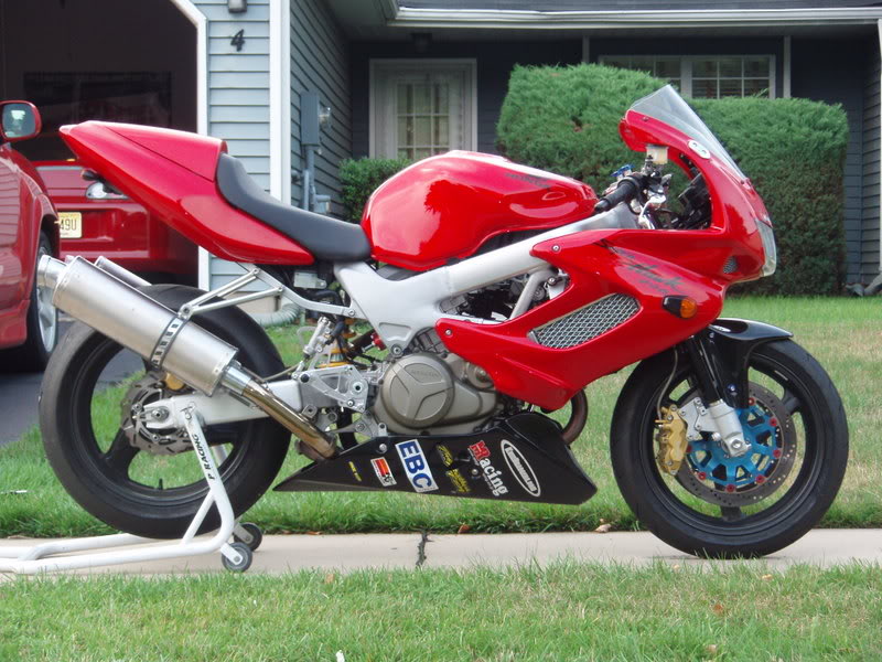

hello.... i dont know why i took so long to join this forum but i had my 2002 superhawk since it was brand new and bone stock, now it has almost 24k on it an i did all the modifications myself... here it is... let me know what you thik Name:  vtr1000f.jpg

Lookin good. I definitely like the exhaust. Not so much on the blue rotor carrier, or whatever it's called, but whatever. Looks like you're using it for street and track. Does that mean there are some mods we can't see, like fork springs, and the like?

looks great, i like the rear wavy rotor. Bike looks to be real clean to.

i only ride it on the track now the only time i ride it on the street is to test a modification... look closeley thats a 900rr front end and i also have attack racing rake adjustable triple clamps and race tech fork springs.. the brakes are ebc 320mm big brake kit ductile iron rotors (wich only come in blue ) and gsxr1000 6 piston calipers + stainless lines + vesrah rjl pads which are the $#it by the way....

I like your bike but I would like to know where the muffler hangers came from.
If you made them, great job, if you bought them, from where ?
I'm running RC51 mufflers and they are halfway between stock and where they are on the RC51
Your hangers look like they might be the perfect fit.
And they look better than mine.
Would you mind measuring the distance from the subframe to the muffler mount ?

Looks like Driven2Madness likes RED based on the pictures... a RED Supra and looks to be a RED X-Runner.

I knew the front end looked different! I definitely didn't know what those fork lowers were trying to tell me though...

Cool rear sets and sprocket cover. WELCOME!

yeah red is my favorite color... kudos to ohio hawk for spotting the x-runner and the supra, its a 2005 x-runner its my daily driver, the supra is a 95 single turbo 6 speed hardtop around 500hp...i also work at a toyota dealership thats why i have all toyotas.. to answer kai ju from the rear mufler mount hole in the subframe to the bottom hole is exactle 8in from center to center the brackets came from two brothers. my mufflers might look a little high because i modified my subframe to give it a little more angle up so it also pulled the exhaust up too...i also lowered the front fairing about an inch so i can drop the bars a little more.. it looks more agressive....

Thanks for taking the time to measure your mounts, on mine it's 6" so I'll have to either be happy with mine or make another set.
Dropping the fairing is a subtle but effetive mod, looks good.

Jesus!! out of nowhere one of the sickest Hawk's I've seen! Lowered the Fairing eh? thats and idea! Wow, nice bike. WElcome to the Forum, looks like we can learn alot from you!

Whoa, rear subframe tweak. That's sweet. It flows well with the front fairing.
