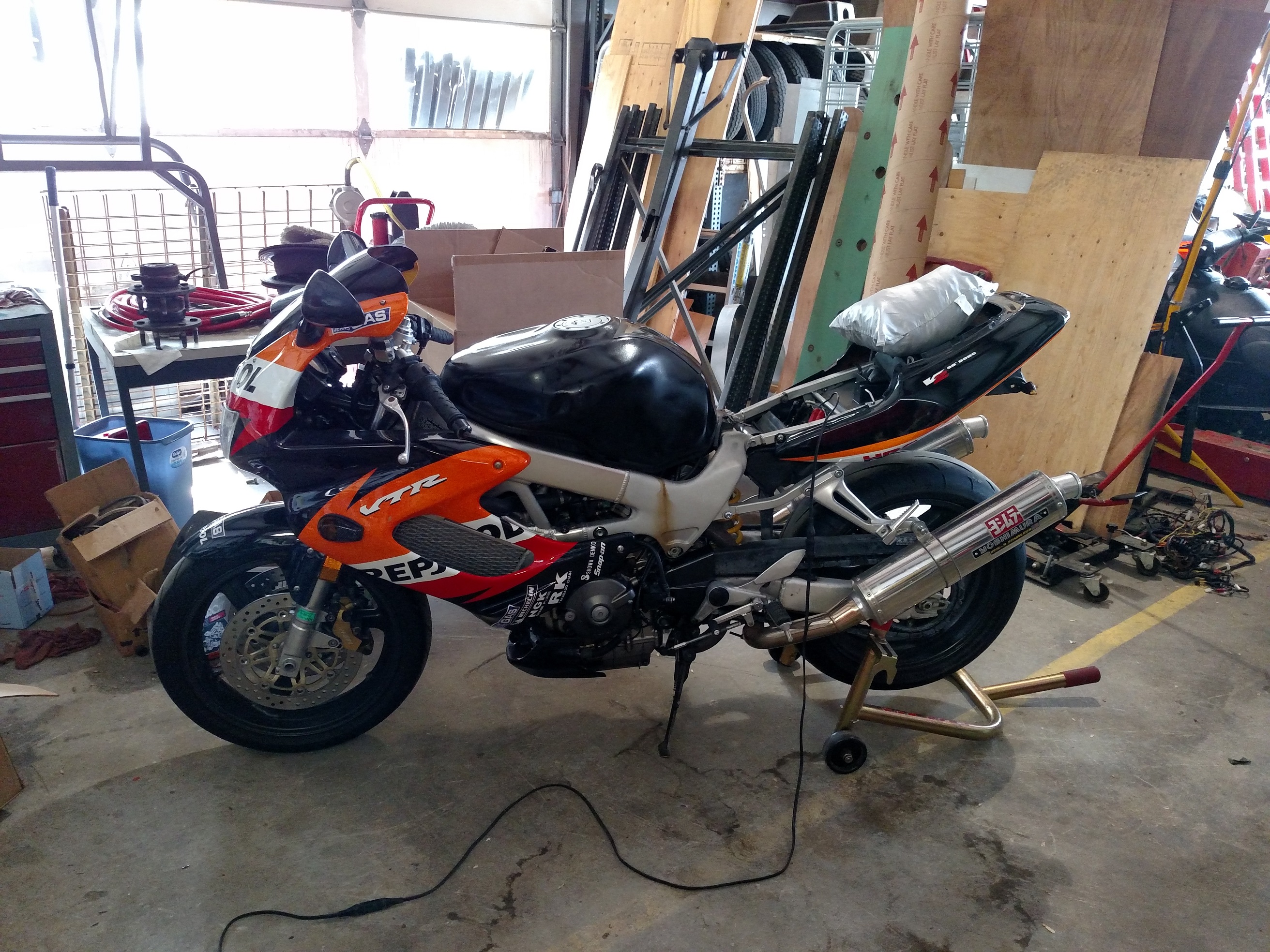

Hey guys! I just picked up a 98 Hawk this past Saturday. Needs cam chain tensioners (going to get the APE manual ones), has a fuel leak (probably the petcock) and other than that it's in pretty good shape.

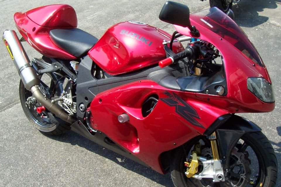

I'm no stranger to bikes, I had a 2003 TLR that was HEAVILY modded out. I haven't had it for a few years now and when my friend's brother offered me this VTR for $1k I couldn't say no.
I look forward to learning a lot about this bike!
I've attached pics of my old TLR and my new VTR

Looks nice! I'm sure it'll be amazing when you're done, like that red TLR. Did you do all the work on that one yourself?

Well I got it torn down tonight. Front tensioner is toast but it looks like the valves are OK. Time to order up the Ape tensioners. I also found the fuel leak - it's coming from the sending unit. I'll get that o-ring replaced and not worry about that.

before you order that O ring I would take apart the petcock and check the condition of the diaphram... its a semi common problem with these bikes and you could just order a rebuild kit if needed.

The petcock is fine and dry (but I already have a rebuild kit coming for it) buy the sender was soaked.
