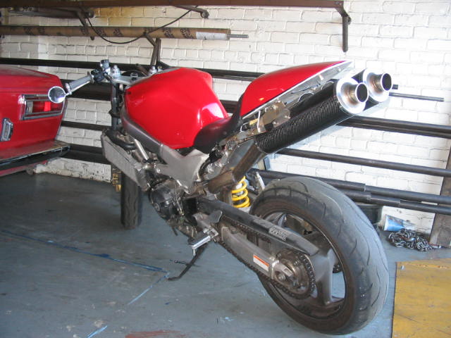

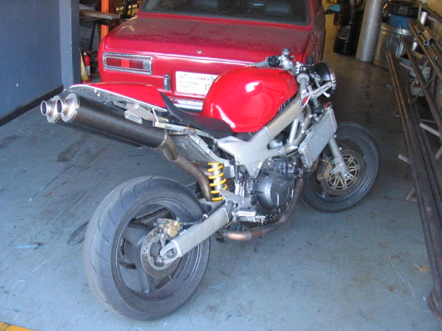

Hey all,
New lister, thought I'd post some pics of my work in progress for your perusal. Keep in mind this was a $800 Hawk that needed love to come back to any condition. We'll see how it ends up.....
Dan
Attached Thumbnails New Hawk owner, pics of my project-08-11-08-021.jpg   New Hawk owner, pics of my project-08-11-08-022.jpg

Is it a runner? There can't be enough room for the pipe(s) through the swingarm/shock location or is there?

Yep, it runs. Going to have to do some serious tuning to get it to run RIGHT due to the super short rear runner. "THEY" say it won't work. We'll see. Under WOT it is a scalded dog, but has some minor teething issues.....
4 degree wheel, raised seat, 2" stainless to 2 Carbon canisters, K&N, jetting still to do. Yes, I know it will may be be a cantankerous hag when it is all said and done, but we'll see...

Ever thought of welding a flap inside the rear exhaust header pipe.. sort of like a "choke" to make it "think" the rear header pipe is longer? Make it create more back pressure.. to more equally match the front pipe..
I considered doing exactly what you've done here.. I'll definitely be keeping tabs on this..

Funny you mention that. I've been looking at electric cutouts and Vacuum ones too. TOO BIG. A spring loaded flapper would be the ticket. The idle and off throttle response definitely gets better with a coke can sealing off one of the cans.....

Love the build so far. That exhaust is trick!

I like it. I would be very intrested in how your tuning progress goes, as i have a 05 R1 tail on my hawk and have the mufflers mounted the way you do. The only difference is that my mid pipes go around the swing arm like the stock ones do, but i want to do the same thing with the head pipes as you did, but i didn't know how it would run with such a short rear runner.

That's a good looking street fighter you got goin there. Gotta ditch those side mounted rads though. Otherwise it looks pretty tough.
