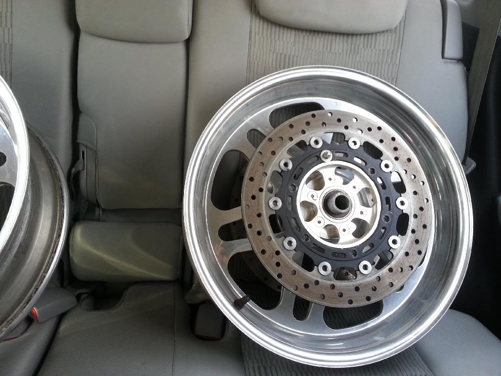

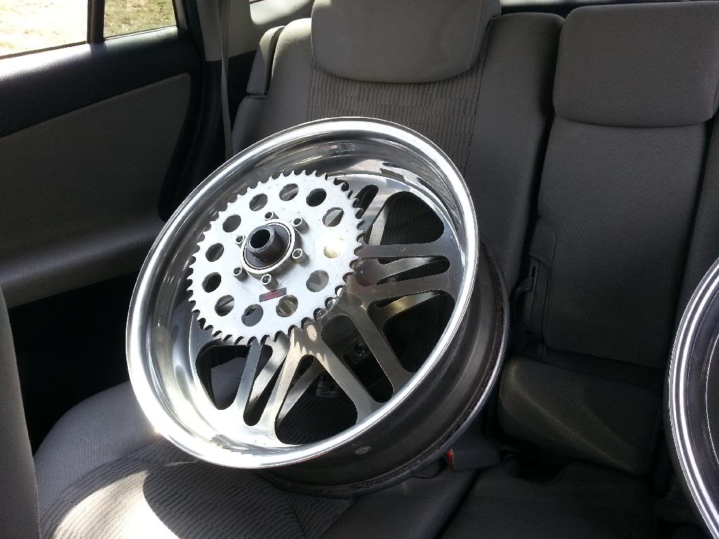

Old Apr 19, 2014 | 12:51 PM
I'll make 'em fit
Purchased both RC Custom wheels for the price of one six spoke front wheel I was looking at.
Going to paint or powder coat (unsure at the moment) the rim matte black and the inside the same matte electric blue as the bike or vise versa. Should look sweet! They look to be a real bitch to clean though.

Just weighed the new twins:
Weight: 10 pounds 0 ounces*
Name:Big 'n Rear
Weight: 15 pounds 0 ounces*
*Weight was taken with a bathroom scale which is pretty accurate with a doctors office scale. Your weights may vary.
These look to be quite easy to fit the Superhawk. There are adapters that bolt to the side of each wheel which locate the sprocket and brake discs. Looks like worst case scenerio, I order new adapters and viola! New wheels fitted.
EDIT: They are non ferrous, so I'm assuming these wheels are aluminum or possibly...magnesium?
Last edited by CruxGNZ; Apr 19, 2014 at 09:29 PM. Reason: Carefull farting after eating Taco Bell

do they seem to match up into the swingarm okay? wondering if youll need any custom spacers. the hub is not too wide? they look pretty sweet, except for being silver.... but all that shall be taken care off.
good find! weight the stock wheels! id love to know what those beasts weigh
