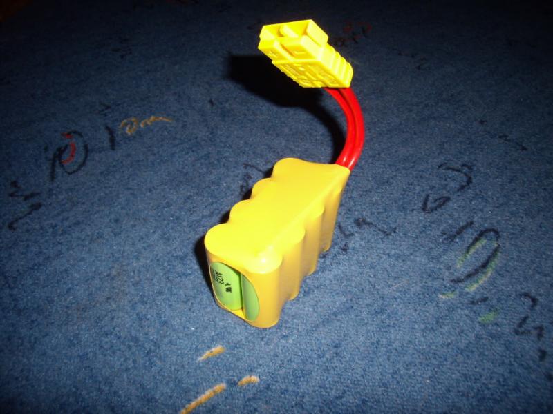

Well... The SB50 in the picture is rated for 250 Volts 50 Ampere, ie more than enough to handle the ~12V 25-30A current our batteries need to pump through on start-up... It's a battery connector, so it's non-reversable... Ie once you have gotten the polarity right on installation, it's impossible to screw it up on usage...
The image shows the connector on the battery, the "other end" is just an identical connector and two very short leads with ring connectors... Slide a piece of heatshrink tube over each, bolt it to the bike's connections and heat the tube... Now you can disconnect the battery in just the time that it takes to pop open the seat and battery tray...
On the batteries you buy from Jamie D, cut off the ringconnectors and replace with these, and get the same wire gauge for "the other end" and it's done... Or ask nice and it's probably possible to have them delivered with them installed all ready...

tweety, what gauge wire do you suggest i use with those connectors?
Old Nov 15, 2011 | 02:45 PM
Well, since you guys over on that side of the pond use an arcaic measuring system, which I cannot memorise, and since I'm to lazy to look up the equivalent size, you get ballpark size...
Basically the size of the existing connecting wires is about right... They are actually slightly oversized, but not to the point where it starts to cause parasitic loads... So whatever closest in size to the two wires to the stock battery ears are, or one size smaller...
And I really do recommend using multistranded copper wire, usually marketed as battery wiring or for car audio purposes since those are much easier to bend and curve than the coarser one's... Makes for a much simpler and nicer installation...

ahh yes after i typed my post i realized what i had asked was silly. us americans feel compelled to measure eveything differently for some reason.
good idea with the car audio stuff, the systems i have put into my cars do have very flexible wiring. i was wondering about fitting everything under there, with the stiffness of the wire and the connectors being a bit bigger than i had thought.
