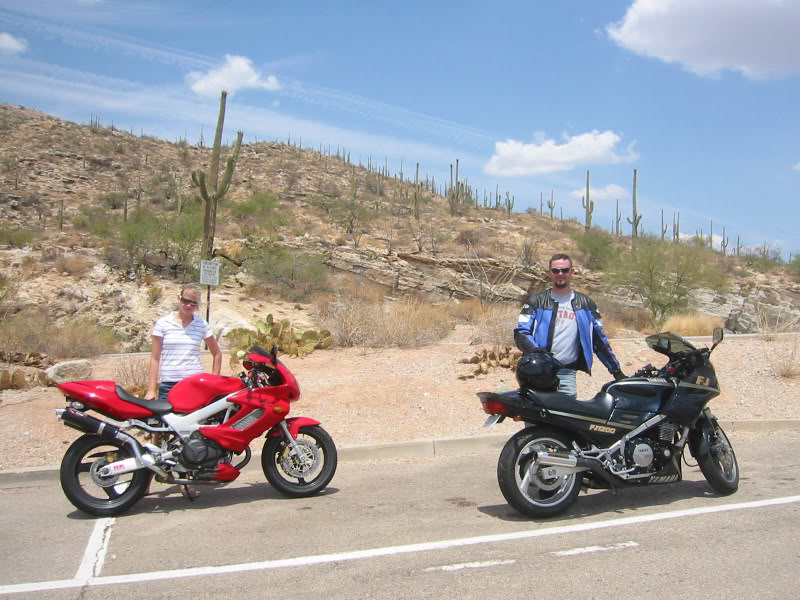

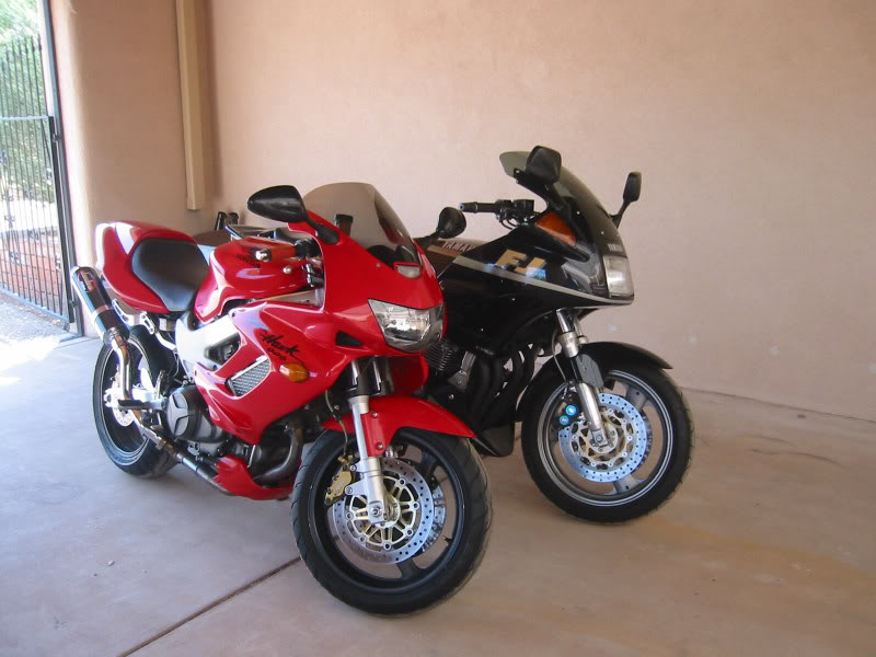

My daughter and brother on the way up to Mt. Lemon, AZ
