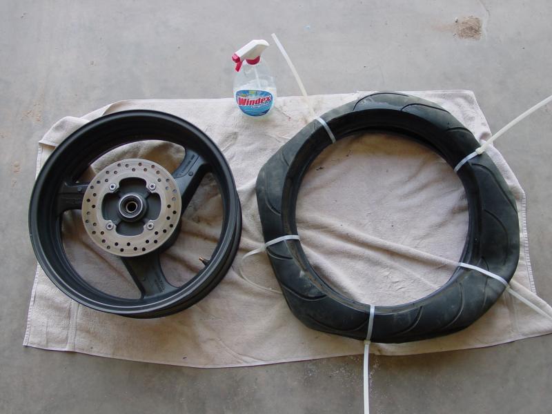

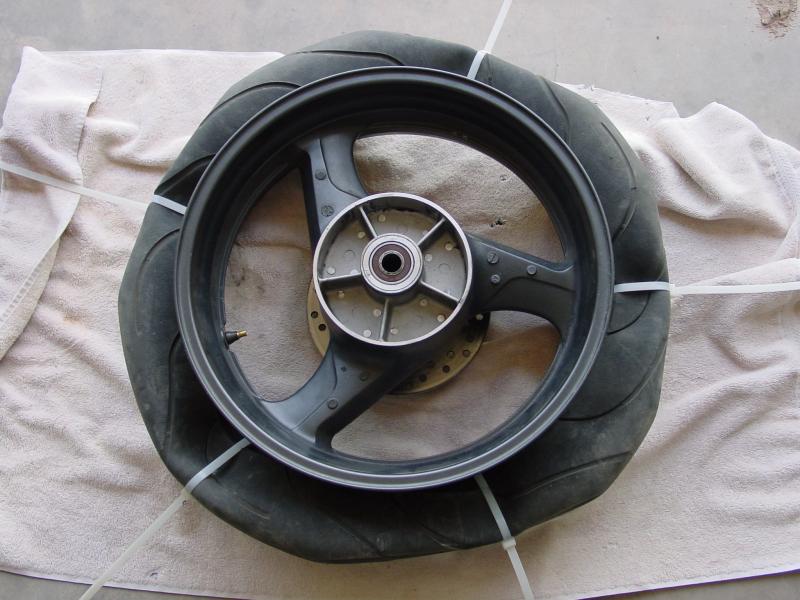

Bike has been down for a while. I pulled the rear wheel so I wouldn't ride it. The tire was showing cords and it was the only way (for me) to stay safe. Was going to have new Dunlop Q3's mounted but when I called the only MC shop in the area (70 mi round trip) they weren't in stock. Saturday was the only day I could do it, which meant another week before a new tire could me mounted. Well DYI, OCD and the need to feel like I made an end run around the cost of having someone else do something I can do myself kicked in. So I dismounted the tire with the lumber and zip tie method. Worked quite well. Ordered a new Michelin PP3 from Revzilla and a balancer from Honda Motorcycle Wheel Balancer
I was concerned about using windex for the lube so I bought a life time supply of Ruglide from NAPA NAPA AUTO PARTS
The local store had one on the shelve, go figure.
Was a little worried about the mounting as the PP3 is quite a bit stiffer that the PP2CT that came off. As it turned out it went on with almost no effort at all. The lube really made it easy.
So on to the balancer. Wheel only the heavy spot was not at the valve stem (put a K&L angle stem on). Michelin tires don't seem to have a mark for the light point so not really knowing I use the bar code that is on the bead. With the tire it took less than a once to get a perfect balance.
