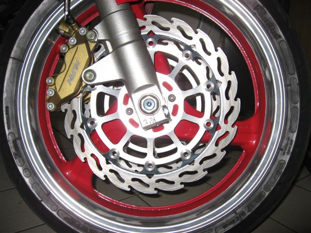

Ok, back again. Nice discussion about the carbon rims... Enough...
What I was talking about, forged aluminium rims from:
PVM, Galespeed...
http://www.oppracing.com/products.php?id=116
And PVM also has good braking systems...
If you only search for braking disks, try this...
We were discussing about them in the german forum, here some stats:
Stock braking disk: 1365g x 2= 2730g
Moto-Master disk: 1190g x 2= 2380g
Would be about 350g just a the front. Notice: Unsprung mass! Not much, but rims are very expensive... But the reduce better. Those wave disks are stock used at supermotos and motocross bikes. You could get them from every known company, as ABM, Brembo, Behringer, Moto-Master.....
Got a pic.
Reinske is offline
