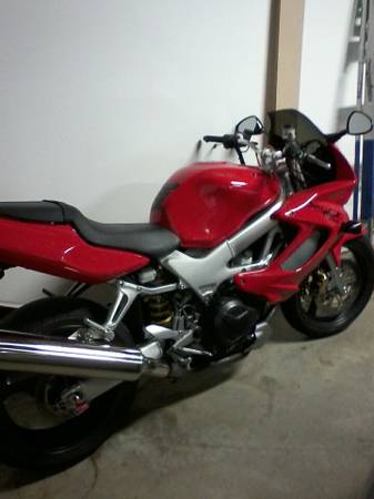

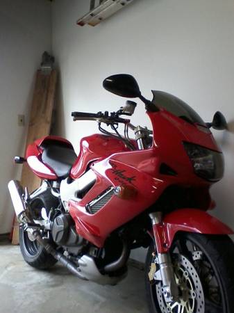

These are the only pictures I have...
Attached Thumbnails Looking at 98-superhawk1.jpg   Looking at 98-superhawk2.jpg

Looks pretty good to me, clean and unmolested. These bikes are an enormous amount of fun and I have no regrets buying a 98 with 25k for 2500 (which is dealer retail price in my area) I would do it again.

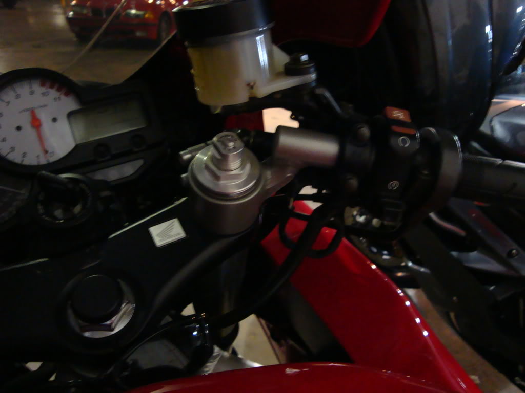

dug, I'm seeing a hack job on the fairing! Those are far from Heli's! The bike has risers installed onto the top yoke. To do this, holes were drilled to mount them, then a set of handlebars were put on. Significant rise! So much so that you need to cut the fairing to clear the bars. Looks like the windscreen may not have escaped the saw as well. Look close before you give up cash.
Here are a few close-ups of similar set-ups:
Here's a set of Helibars:

Crap... I see what you mean. I googled some other images and the fairing and windscreen have been hacked up but good. Oh well, I'll keep looking. Thanks for spotting that!

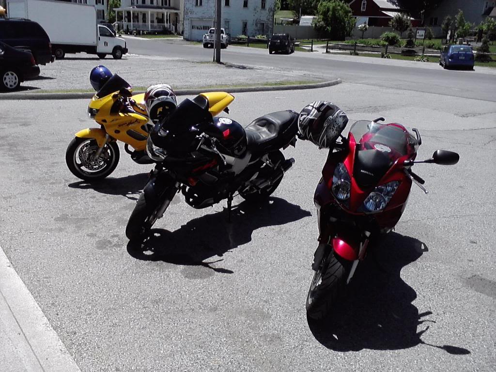

I've got 26xxx on mine and haven't checked valves... Viffers are nice bikes too although a little heavier than the Hawk.
My last group ride:
