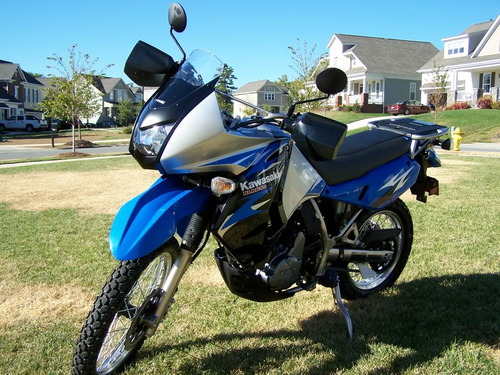

Also, you can use photobucket.com upload, then choose the option below the pic IMG code, copy and paste it in your message, and the pics will show up without others having to click a link...
Size:  236.8 KB Like this
Sorry, couldn't help myself...LOL
But it is relevent, as I am thinking of doing this to my new bike...well, maybe not...but I could..LOL....
Good luck with the Hawk boxes...patent term...ok, maybe not, but it could be...LOL
