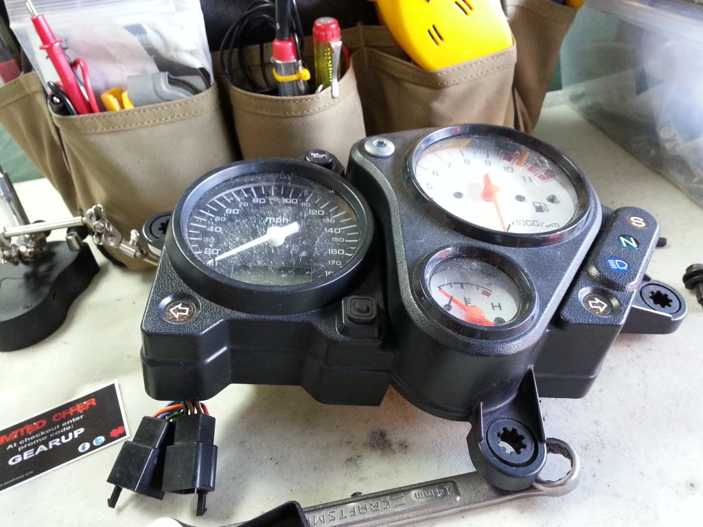

I figured out how to post pictures with my iPad, so now I can finally show what happened. You can't see the lenses very well with the white gauge faces, but they look the same as the lens over the MPH gauge. Even the temp gauge is shattered. All happened at the same time.

That looks like they first had some chemical on them that etched them. Even if one failed, seems unlikely they would all 3 fail the same way without the same thing sprayed on all 3. I have seen that before (not like this but similar).
I dont see how the same exact temp couldve befallen all 3 simultaneously. But still that is wierd.
Old Apr 23, 2013 | 02:43 PM
Chemical? They were crystal clear before they shattered. What kind of chemical have you seen put on gauge lenses? Or was it applied by accident?
The whole temperature thing was just the first idea that ran through my head that might have caused it. It could have been anything I guess.
What's odd, is that the shattering looks like it starts at the bottom of each lens, then fans out as it gets to the top of the gauge.
After taking the gauges apart, the shattered lenses look like they can be busted out and new lexan installed. If I go that route, I'll have to figure out a way to make them convex, so I don't get blinded by the sun. I'll have to look into a plastic coating or film to keep the face of the lexan from scratching. I wonder if the lexan would yellow from UV rays?

No, Lexan doesn't yellow. It's a polycarbonate, not acrylic.
But looking at those pics, they do look like stress cracks from heat. I used to fabricate signs from many plastics, and if you heated the edge to polish it with a flame, that's what you'd get. Which is why we polished with sandpaper and rouges rather than heat.
Old Apr 23, 2013 | 04:44 PM
Yeah by accident. Like brake cleaner or some other really harsh chemical that hazed/etched them.,
