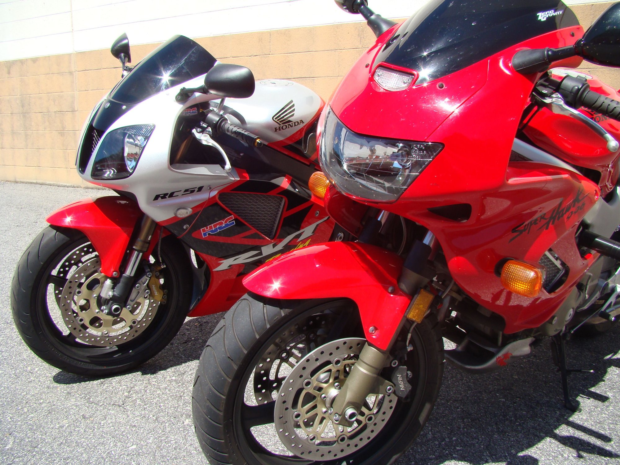

Ok my input on this topic.... I owned a Super Hawk for 6 years and now have a 2004 RC51 for the past 4 months... I just sold the Hawk because I just never rode it much after getting the RC... Now compairing the two.. the RC will run away and hide from the the Hawk in power,braking,handling and gas mileage..yes gas mileage... I hated the stock seat on the RC so I changed to a Sargent and the bike already had Heli bars so I have no input on the stock bars also the RC had a PCIII,LeoVince exhaust,rev mod,flapper mod,gearing changed, rear shock shimmed 5mil and a steering damper... Also my Hawk had all the normal mods and suspension work (springs valving etc) so don't think I'm compairing it to a stock Hawk.
I have heard the horror stories about the RC's overheating and surging at slow speeds in traffic but its not the case with my 04 RC, the mapping in my PCIII is dam near perfect... So to sum it up my Super Hawk was a GREAT bike... I'm 47 years old and I feel I'm a accomplished rider and have owned many bikes over the years and the Hawk ranks high on the chart... As`for the RC would I ride this bike back and forth to work everyday even though it's comfortable for me... Hell no thats not what it's for... but put it in the twisties and say goodbye.
Old Oct 15, 2007 | 07:00 PM
Ohio Hawk's Avatar
Joined: Feb 2005
Posts: 205
From: Cincinnati Ohio
99 Hawk and 04 RC
Attached Thumbnails diff between hawk and RC?-dsc00832.jpg   diff between hawk and RC?-img_0044.jpg
