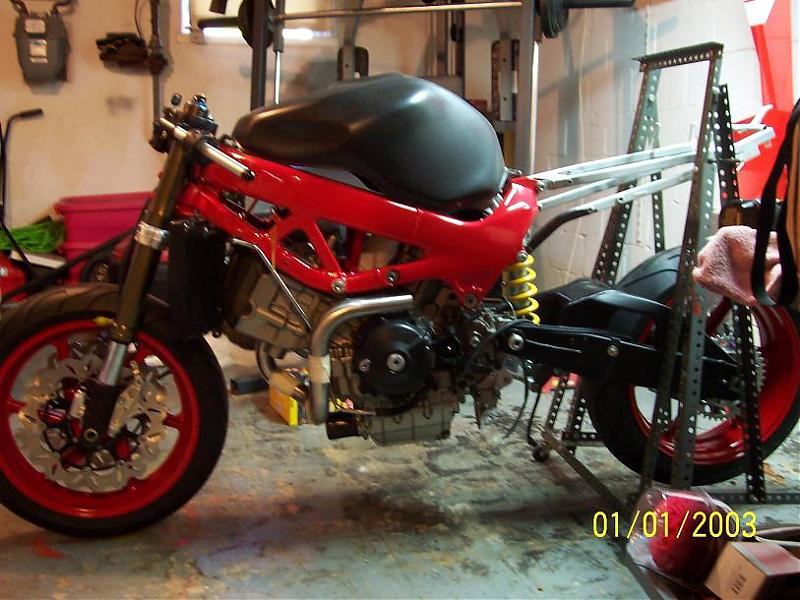

900rr rear will fit.
front f3/f4-avoid f4i
you could paint centers and polish lips or powder whole wheel.
powder is more durable of course.
what type of swingarm is that? looks nice.
swingarm is rc51-sp2
