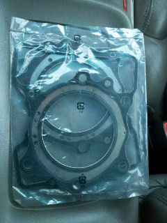

Are these VTR1000F head gaskets?
The question becomes,, anyone want to take a guess if what is in the picture are really VTR gaskets?
Pretty sure they are.. but like many of us who have spares from many different bikes, current, past, etc on the shelfs. Sometimes things get mixed up.
I'll have the head off tonight but wanted to see what you all had to say..
Thanks.

FL02SupaHawk996's Avatar
Fastest Color
Posts: 2,091
From: Lithia, FL
Can't tell for sure from the pic but they look right:https://www.superhawkforum.com/forum...ad.php?t=17262
Old Feb 16, 2011 | 06:55 AM
Looks like they should be the correct item, but it's hard to tell for sure... Keeping my fingers crossed...
Old Feb 16, 2011 | 07:00 AM
Me too, should be here tonight or tomorrow, head will be off tonight.. With luck, and weather holds.... I'll be riding by Sunday ( Racing Sat, or we would be out then as well)
Old Feb 16, 2011 | 09:11 AM
Like the others have said, they do "look" like the correct gaskets.

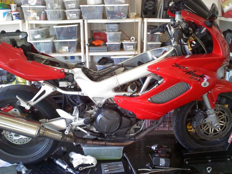

Life happened..... so have been putting off the tear down till today. On the bright side, a Marquez Racing Bike took 3rd at Arena Cross in Belton Texas this weekend (my son ) And 900 feet of fence posts were driven into the ground
60 minuets in to it..

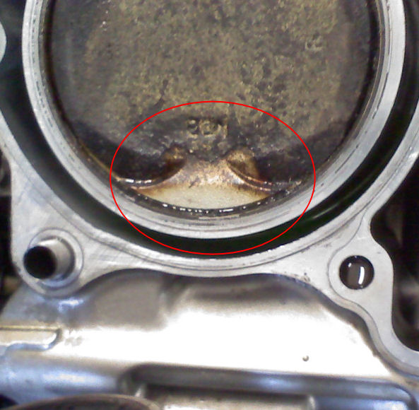

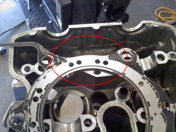

And it is apart.. and confirmed, head gasket leak.
You can clearly see the area the gasket was leaking at, and it exactly matches where I was seeing coolant on the outside rear of the head.
And you can see the very common "clean" spot on the piston, typical of a steam cleaned piston when you have a coolant leak.
