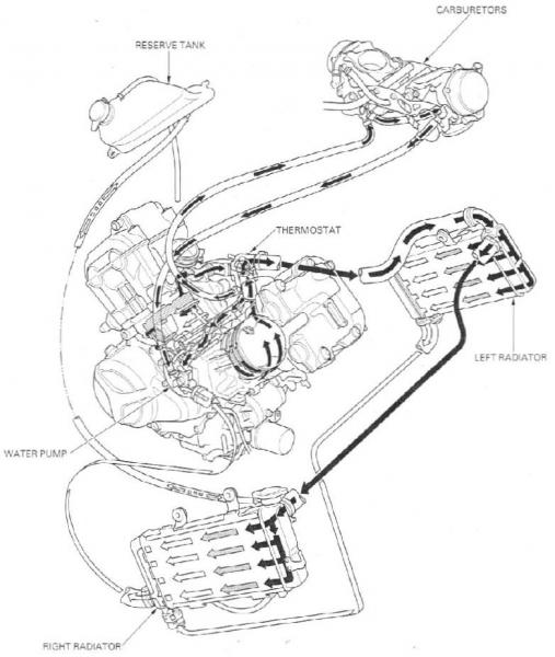

Anything off the left side is probably a hose or something. Check the thermostat housing. It's in the Vee on the left side.
Here's a pic of the whole cooling system:

alright thanks for the info and picture guys. the bikes getting looked at by the guy doing the upgrades to it so he said hes gonna sort out whatevre it is. ill let you know what it turned out to be when he lets me know
