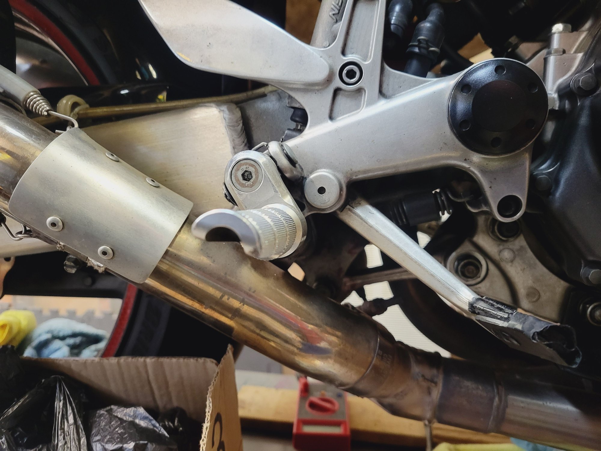

Posts: 2,219
I modified my Sargent wider and +1"
MFW Vario adjustable pegs lower -3/4" & forward 5/8"
Had the Genmar bars (sold) and the Tommaselli adjustable clip-ons (for Sale) until I got the sweet DanMoto 3D clip-ons which did the trick. Unfortunately they are now unobtainable; I checked, even directly with them. They do not hit the tank or fairing but I did drill & tap in a screw limit steering lock a few degrees. There ARE other adjustable clip-ons out there...

All the suggested mods (riser clip-ons, padding seat, etc.) Cycle Pirates makes an adjustable set of 40mm foot pegs.

Anything lower than about an inch and the foot brake lever can't be lowered enough and that's with removing the locknut and shortening the actuator rod end 3 threads
