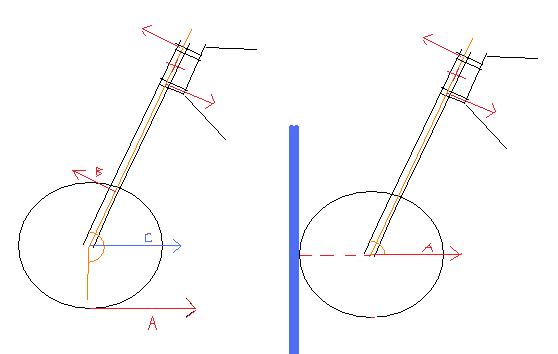

Originally Posted by filter69
I hate to do this but could not let it go.
Accroding to newton's law of motion
The principle of motion can be derived. Which was first thought of
by Archimedes.
The amount of work done is given by force times distance.
So if the force is applied 12" higher on the tire(i measured) it changes
the force applied to the steering head. We can look at the forks as simply
a first class lever if you shorten the lever the force applied is less at the fulcrum. Ever used a "Cheater" in a wrench or a rachet ? The longer the cheater the more force applied to the item you are attempting to move. So reducing the length of the cheater would result in a diminished amount
of force to the item. Now with that said lets take into consideration the torsion on the forks from the brake calipers biting down on the rotors wich are attached to the forks (this is using the no wall/tree method)would apply a different force to the forks causing them to flex theoreticly in the middle of the two points of attachment (steering head and axle pin).
While the bike is designed for these types of loads/forces in your statement. You said that the forces on the forks/steering head would be the same. Which i believe is a incorrect statement.
Now i will shut up.
Hmm, now I want to get a strain gage and measure it.. But I am SURE that with the same forward force from the rear wheel, the same strain will be felt by the forks and steering head either way.
I think that because of the axle being the point where the force is applied in both situations, it is the end of the lever..
You can't count the wheel as a "cheater bar" because it isn't actually adding to the length of the forks.
I am sure there are more complicated issues involved, twisting force from the brakes, etc.
Any physicists in the house?

Well... I did actually answear that question... but again... in a different way...
The wheel is part of the cheater bar, but the main part is the fork... it's just that the fork is angled... so the last part of the cheater bar is vertical ie the distance from the axle down... and then you have the torsional force applied by the brakes forward on the fork... so yes it's complicated...
However with the wall the cheater bar is the fork only... and there is no torsional force from the brakes...
So no, they are not the same...

Ok... the force A is always the same as the driving force from the rear wheel... ie burnout... otherwise you are pushing the front...
With the wall the force can be moved along it's axis as it's angle is unchanged...
Without the wall the force C is the resulting force of the force's A and B and thier respective angles and leverages... with the front wheel axle acting as the center of the force's A&B, C then acts at the fork from that point...
And yes... there are about a hundred other forces to actually calculate in there for it to come close to reality...
Ok, I get all that, but won't in the 1st case force A and B will by virtue of rotating around the axle cancel each other out and make force C equal to force A in the 2nd case? Obviously not 100% identical, but close enough as makes no difference.
