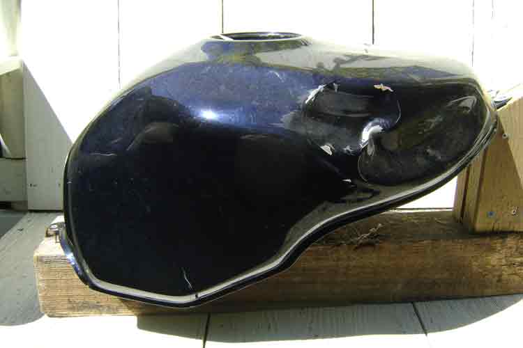

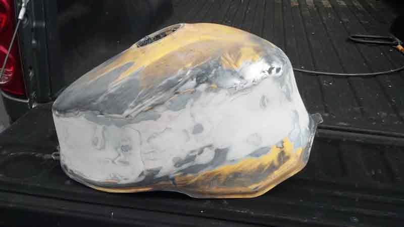

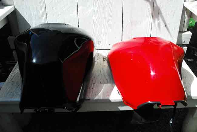

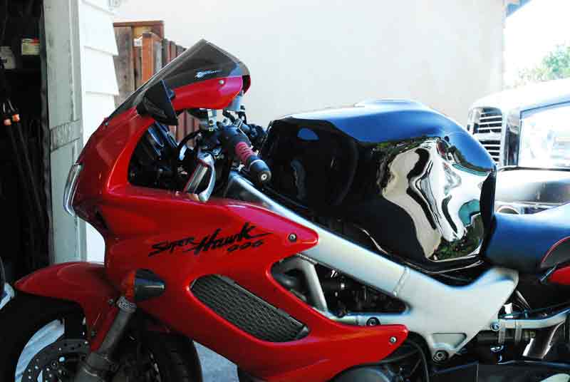

In preparation to ride to Alaska and back, I decided to make a larger gas tank for my Hawk. I bought a damaged tank for $100. I cut the tank in half horizontally. Since I had located a vented gas cap, I decided to plug the vent and overflow tubes to make my job easier. My friend, Mike, welded a 4 inch band of steel between the two halves. I can now go at least 250 miles on a tank. The only problem that I encountered on the trip was a vapor build-up between the gas cap and my tank bag (I am in the process of making a spacer to place between the tank and my bag. Now I have a touring tank and a canyon tank. Total cost excluding labor was about $500.

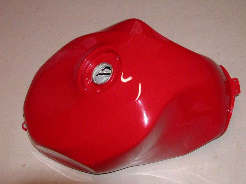

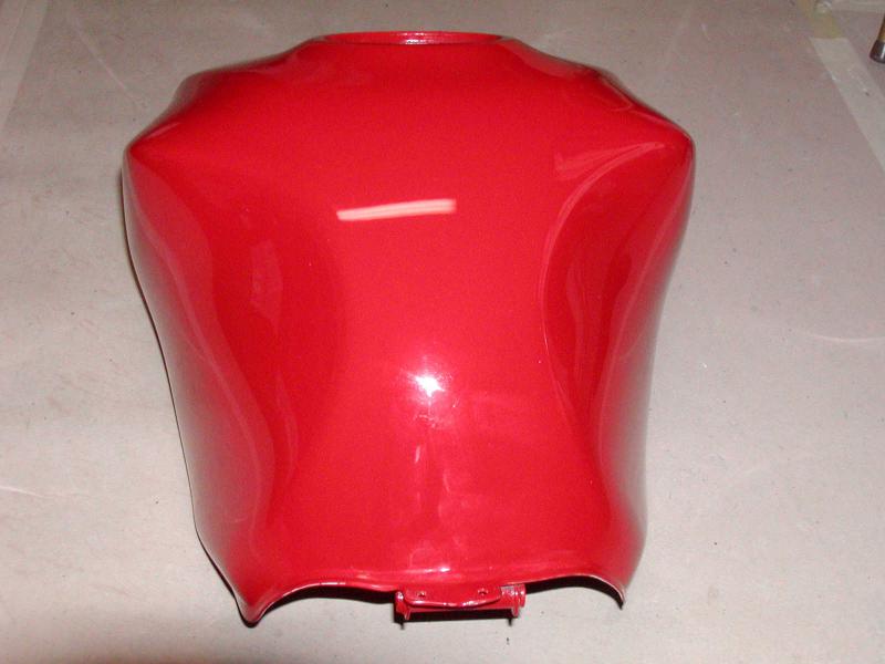

That was me. Back in 2003 I also used a special alloy steel and phosphate treated it before and after welding, then cleaned and coated the interior with POR15 two times.
I was actually thinking of selling it as whereas old age and treachery trumps youth and exuberance, one's prostate limits range to the OEM fuel tank capacity mileage...
The vented gas gap I found (though did not buy), as the OEM vent is intact is made by Yoyodyne, and accordingly is pricey.

been a while since someone looked at the original of my thumbnail
Actually rode 110 miles with it on my back, empty on way to modding it.
