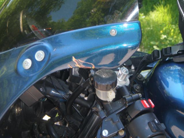

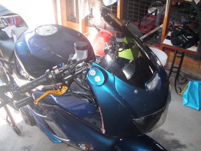

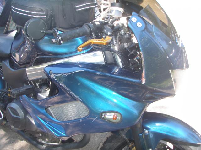

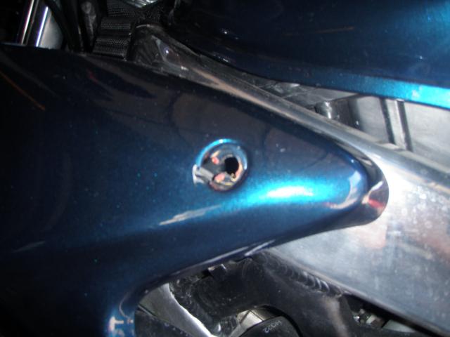

Old May 31, 2013 | 05:35 PM
Those plastics look very fixable. Little elbow grease, sanpaper, barely tell. Maybe some plastic bumper filler or plastic welding.

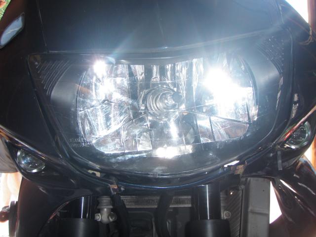

Is the headlight broken? Hard to tell in pic. The cage can be bent back in shape with long pipes (scaffolding stuff) and a little anger.

Old Jun 1, 2013 | 07:10 AM
Bandit400man's Avatar
Joined: Jan 2012
Posts: 423
From: ABE PA
Bandit400man is on a distinguished road
Oh man...I went that route with the bandit...LOADS of time spent only to have it fall over in the back of my step father's truck cause he didn't take my 4-point tie-down advice- back to square 1 LOL
But I may try to bend that stay...I do have a 3' stainless 2" ID breaker bar....hmmm...

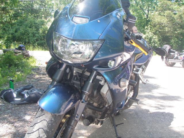

And yeah, headlights busted from the inside oddly...I'll throw up a couple more pics today as I tear into it

I have bent back twisted rear subframes back in the day with the scaffolding pole method and the bike tie downed to a post. That took some determination, subframes are meant to hold rider, pass & gear. Cage should be ex.

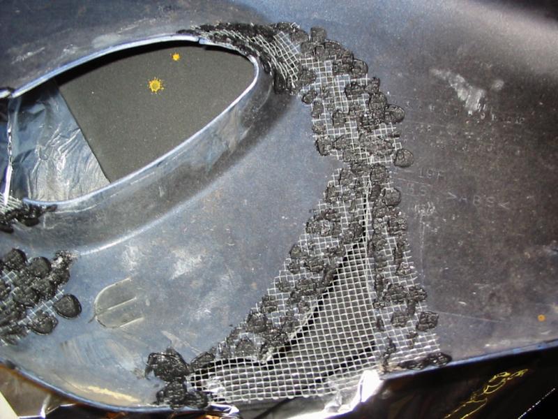

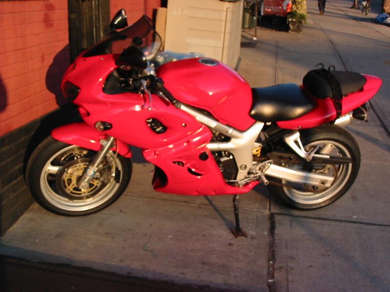

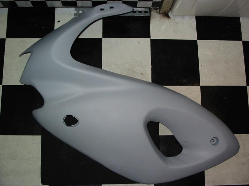

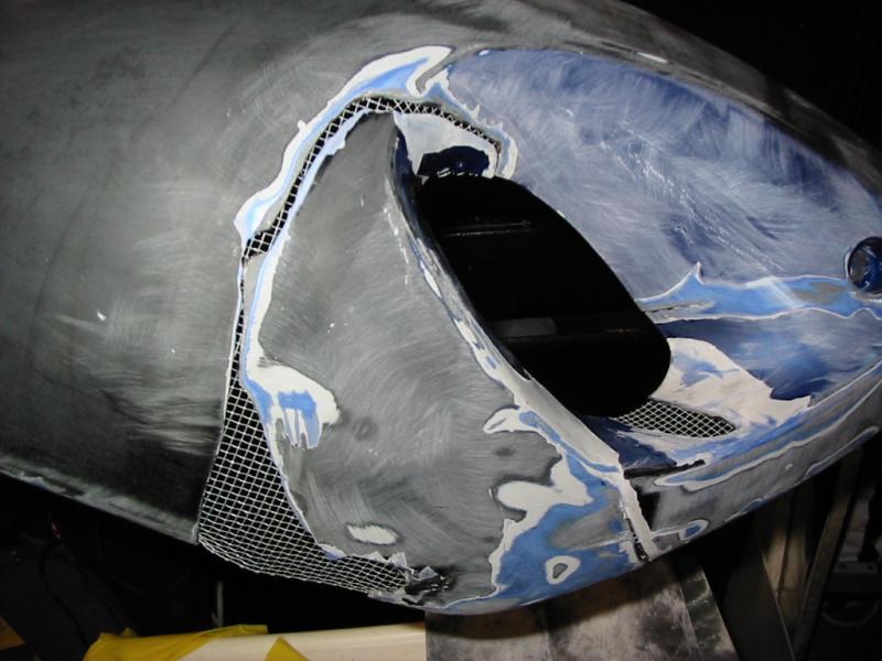

Old Jun 1, 2013 | 10:31 AM

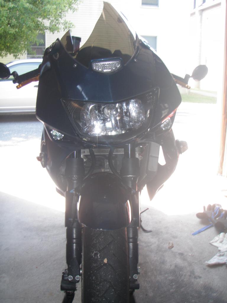

Oh so FYI ICYDK, ABS is a thermoplastic like polyproplene. If you heat it, it still maintains all its properties when melted and resolidified.
I made my plastic welder out of a real powerful soldering iron, and machined a "foot" with a hole for abs welding rod. You can get the rod real cheap at mcmaster-carr.com.
To repair cracks you can melt steel mesh into existing pieces to solidify it then fill in the gaps with molten abs.
I know I post these pics way to much but its amazing the results, and its all solid plastic! You can sand it like filler to shape then paint
Attached Thumbnails Need to repair after accident! WTB!-absrepairsv10.09-001.jpg   Need to repair after accident! WTB!-absrepairsv10.09-007.jpg   Need to repair after accident! WTB!-ginavisit10.25.09-050.jpg   Need to repair after accident! WTB!-sv-full-fairing-002.jpg
