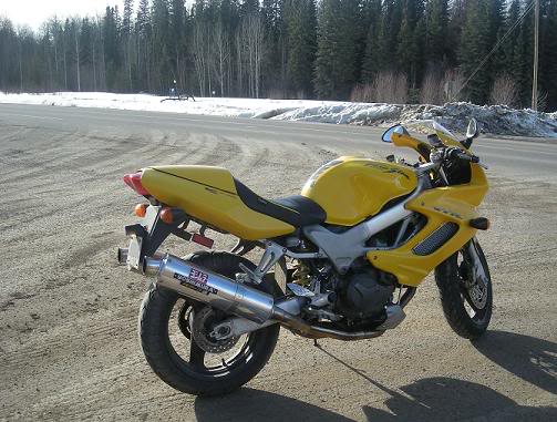

I'll take your advice. With as many miles as I have on this bike it's a good idea. A catastrophic failure is something I wouldn't want to happen of course (although it would provide the excuse to upgrade the top end with h.c. pistons).
I love this bike!
My '98 FireStorm: Yoshimura full system exhaust, Yoshimura Stage 1 cams,
Stage 1 Dyno-Jet kit, K&N air filter, EBC Street Racer clutch, Corbin seat.
