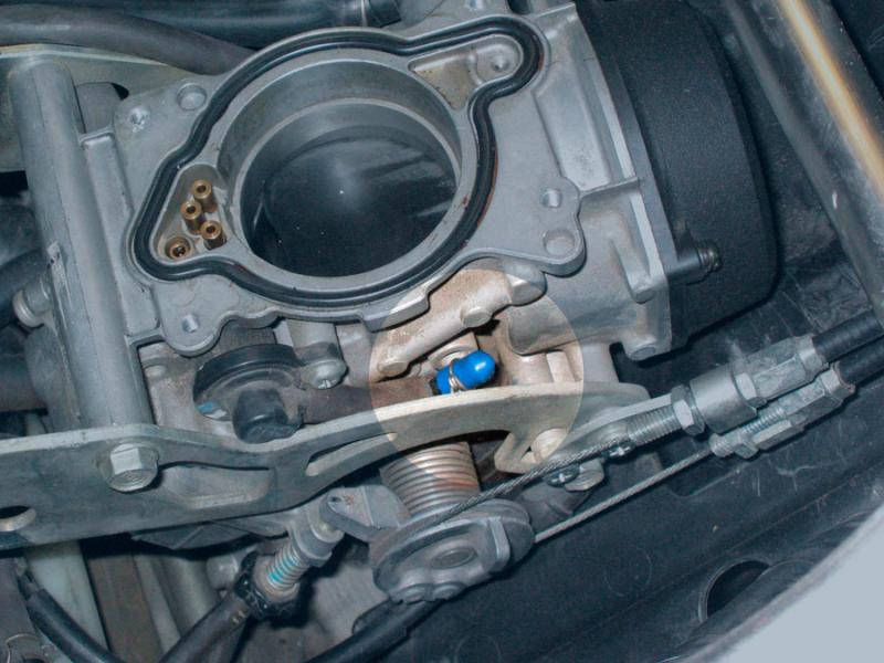

Check small vacuum line on carb. I missed it at first. I plugged mine and it helped. Still pops but not as much.
Here's a picture. Viewed from right side of bike. Not best quality but you can see what to check. Small bit of hose with yellow plug.

Thanks for the feedback, tyronne. And thanks for pointing to that potential leak, fpalbrecht. I'm a bit stumped, I'm figuring now that maybe the carbs aren't properly seated (though they appear to be), or perhaps the seal for the PAIR system that's between the valve cover and cylinder head isn't sealing.
Anyway, I'm about to dive into it once again. Yeehaw!

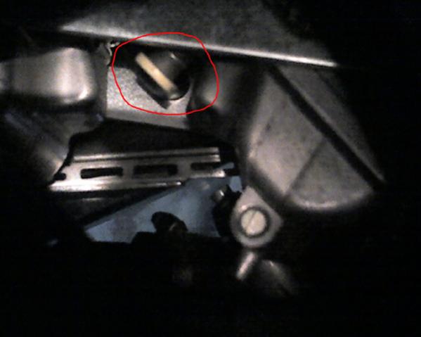

Got it!
Fortunately it was easier than I thought it might be. Once I took off the air box I discovered one last hose that was not capped.
It's back together and the carbs are synced ... going for a ride tomorrow.
