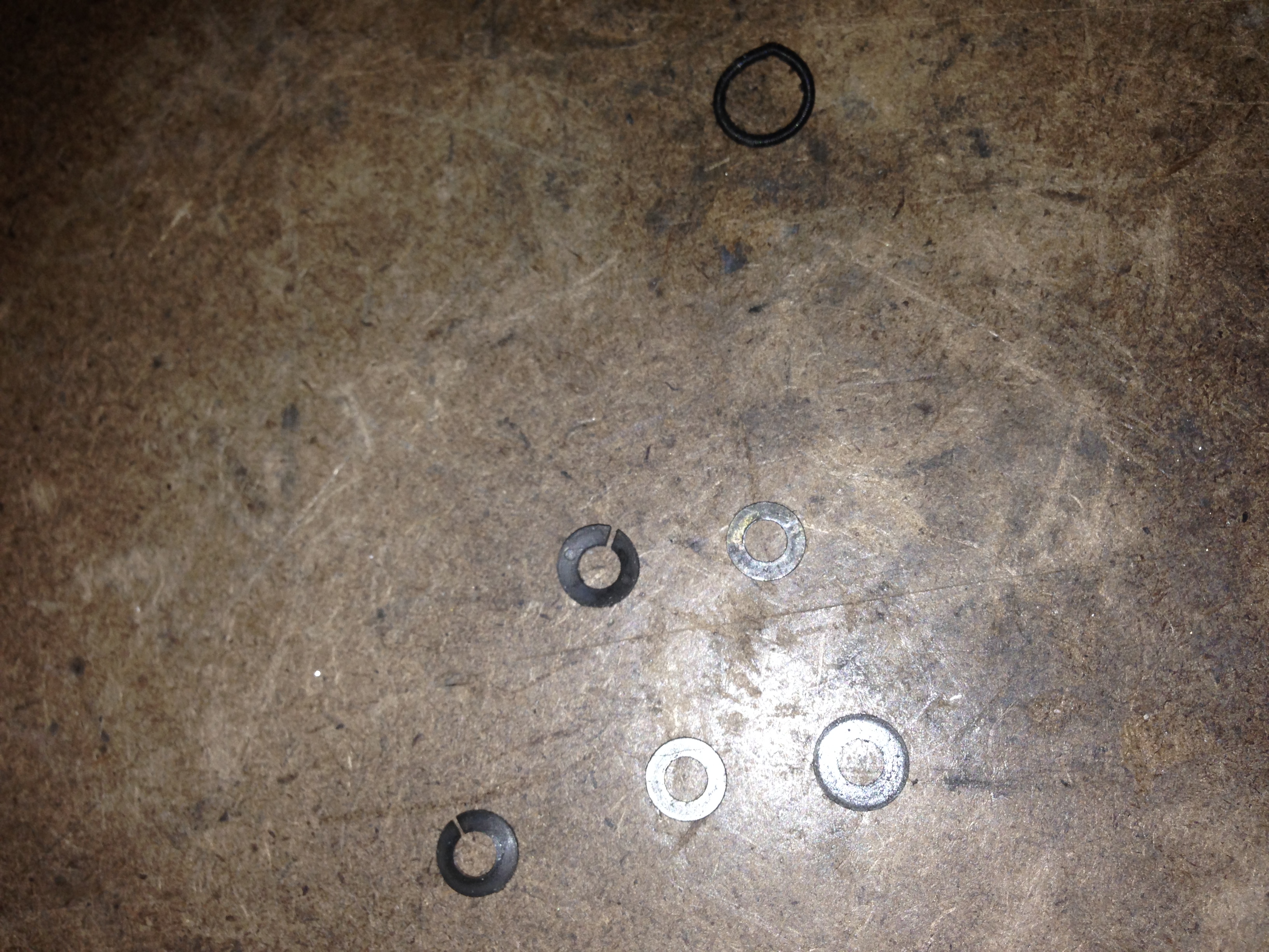

...When putting it all back together, I ended up with a few o rings that I didn't know where they belonged...
Ruh-roh!
Those o-rings go someplace.. and for a purpose!

Would not having those o rings installed actually prevent gas from getting to the engine though?
I only use a quick squirt of start fluid every time. Squirt by squirt.
Old Dec 4, 2015 | 11:16 AM
Can you post a picture of those O Rings?

Won't Start :(-image.jpeg
Can you see that pic?
I think the black ring on the right was from a valve stem seal I replaced. So, you can see how small those washers are. And I guess they were all washers, not o rings.
Two of them are concave/convex shaped and have a slit cut out of them. The rest are all normal and flat.
Old Dec 5, 2015 | 08:53 PM
Are they the O Rings and washers from the needle in your slides?
If it has standard needles these washers may well have been used to raise the needle.
If your needles have grooves in them that take a circlip then they are not standard and I have no idea.

Those were probably under the needles, since that's the only place those would really come from. But that wouldn't prevent it from starting.
Might not be what's causing the bike to fire but it will cause the bike to run like crap. To save him a minute though here is a link to the diagram that Kenmoore referenced above.
Honda Vtr1000f Super Hawk 1998 Usa Carburetor (component Parts) - schematic partsfiche
William you need to go back through the carbs and rrclean / reset them up properly and resync them. Might try cleaning the tank before trying to fire the bike back uo too. Bad gas will clog these carbs quick, thanks ethonol. You need to get the rust out of the tank anyways. Make sure you shim all the needles properly for what ever jet kit you have. The carb set up thread on here is a useful tool.
I've seen it in the past where gas can go bad after just setting a few weeks in a contaminated tank. It clogged the carbs even though we had just cleaned them and had to go through days of head aches before we realized what out mistake was, given that wasn't on a VTR.

I believe one or two of those are just from the throttle link piece on the opposite side of the carb from the throttle cables.
