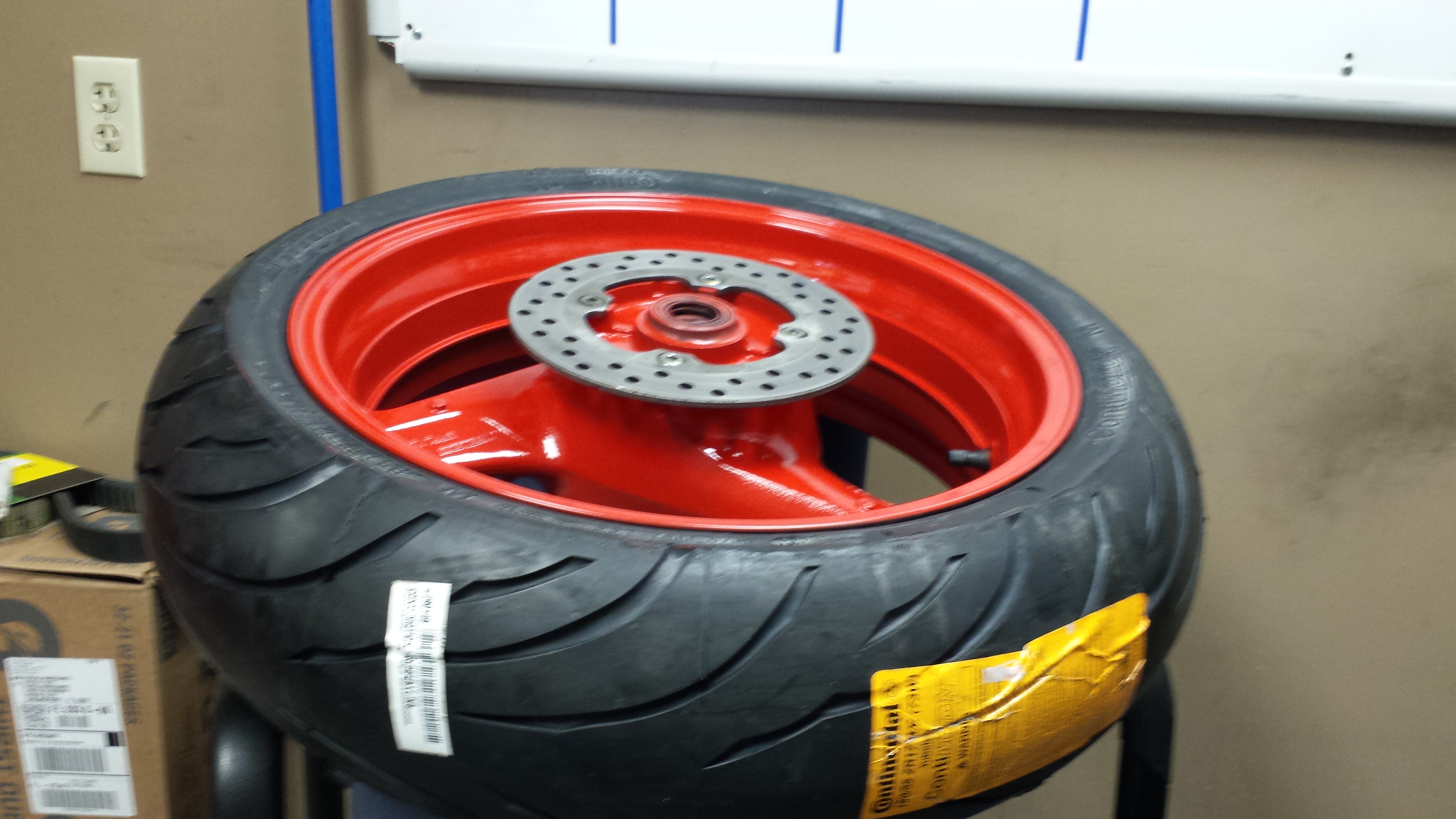

I just mounted Conti Attack tires that I got from Cycle Gear for about $165 front AND rear!
I'm also painting the wheels red to match the bike. (The black is all grey and crusty looking.)
Might as well do a few things while waiting on my parts.

It's HONDA rattle can red with AUTOMOTIVE TOUCHUP.COM 2K clear coat on top for durability and shine and ease of cleaning.
