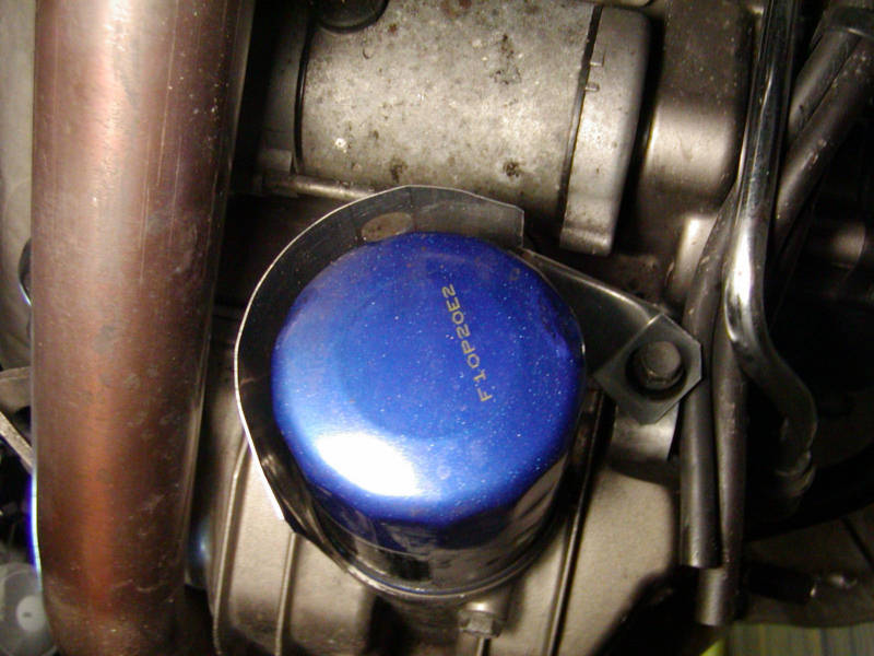

Old Oct 4, 2008 | 12:15 PM
Posts: 2,223
I normally run M1 15w-50 but for this month (cold to date) and mothballing, I'm running Rotella-T syn 5w-50 now $22/gallon at WallyWorld! Any good multi-w syn even down to 5 weight is good but with M1 now over $6.30/qt watch for it on sale. Pep Boys has sales for $30 for 5 qts + a filter which you can use in your cage (or upgrade if the rebate allows to a Purolator PL14612). The PL1612 has better media, bf valve & capacity than OE but requires minor chin fairing trim. The WallyWorld (WalMart) SuperTech ST7317 (less than $3!) and Purolator Pure One PL14610 are 3.25" long; too long unless you really hack your chin fairing.
see http://www.peterverdonedesigns.com/motoroil.htm
and http://motorcycleinfo.calsci.com/Consumables.html

I'm guessing you know (and simply mis-typed) that the Rotella Syn is actually 5w40.
Also, there is another way to use that Pure One, or any other 3.25" filter.
Simply remove the chin fairing and run without it. That's what I do.

Posts: 2,223
Originally Posted by RK1
I'm guessing you know (and simply mis-typed) that the Rotella Syn is actually 5w40. Yep, typo
Simply remove the chin fairing and run without it. That's what I do. Sacrilege but trimming is possible and I run heat wrap and a custom shield to minimize the hdr heat transfer and the chin frg hides it
Molybdenum is the friction inhibitor in most car oils.
Seeing the "twins" oils always throws me off too, but then I remember that I ride a rare breed of twin, one that is tuned for high performance and high rpms. I guess they label it like that to make the cruiser riders and Hardley riders feel special causing them to pay extra for cheaper oil.
I do have some Screamin Eagle Synthetic 20w-50 I need to use. I wonder if that would be ok? ok but otherwise inferior
Shield w/o chin cowl & wrap shown for clarity.
Gas tank OS plus XXrange tank
Attached Thumbnails What oil viscosity to use?-vtr-oil-filter-ht-shld-w-o-chin-cowl-2.jpg   What oil viscosity to use?-long-range-vtr-c.jpg   What oil viscosity to use?-long-range-vtr-2-c.jpg   What oil viscosity to use?-vtr-big-tank-after-end-vw.jpg   What oil viscosity to use?-vtr-big-tank-after-top-vw.jpg
