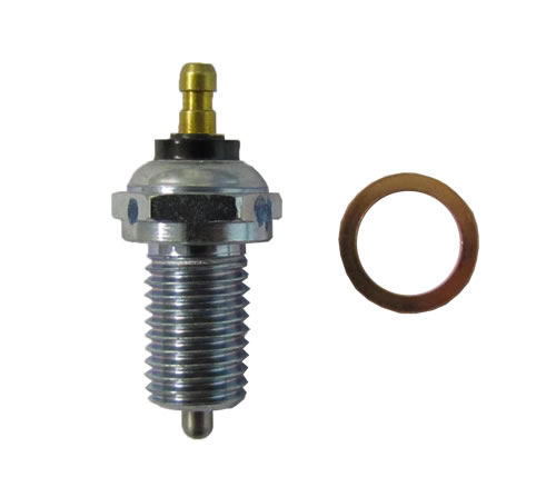

The neutral light relies on the same path to ground i.e. through the neutral switch, as does the starter solenoid. Both pass through the diode and then share a common path to the neutral switch. So the issue could be in the diode, or the wire to the neutral switch, or the switch itself.
The switch can be tested for continuity to ground, should be closed in neutral, and open at any other gear. So a voltmeter connected from the battery positive to the terminal of the neutral switch should show 12v or thereabouts in neutral, and 0v in gear.
If needed Partzilla shows the neutral switch at $11, p/no 35600-KE8-003

No, since the clutch switch at the lever has already been bridged and I do try it in neutral with the stand up, but if the stand switch is wonky, and so is the neutral switch, that would be the perfect storm right?
How hard is the neutral switch to change?

The neutral switch just screws into the engine case, 12N-m torque.

So for sure neutral switch is my first culprit. If only due to the neutral light flickering and going out it heavy hot traffic.
Looked at it and that's easy enuff. My bet it that the neutral switch is the keystone to this. (or maybe the wire but that's easy to change too.)

A neutral switch is only a couple or three ££ / $$ and takes a minute to fit.

Yeah wick, already bought one on partzilla, as well as the sidestand switch. I think that should eliminate most of the possible hardware suspects.

Ok PROBLEM SEEMS GONE.
Today I put in a new neutral switch and sidestand switch.
This totally solved my flickering neutral light. The sidestand switch I believe was heat stroked and was maybe failing when very hot so figured it was a reasonable thing to swap.
Before that I changed the starter, starter swich, and starter solenoid/relay.
I actually ordered the diode before today.
Bike will now start when piping hot which was a real safety issue considering the environment I ride.
Thanks to anyone who helped.
