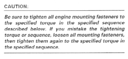

The engine is a stressed part of the frame, thus there is no rubber at all between the motor and the frame. It's all metal to metal, thus the importance of proper torque of the mounts. I believe they must be torqued in a certain order as well. And a special castellated socket is required for at least one of them.
Old Feb 12, 2012 | 08:00 PM
Yep, I was right....
Attached Thumbnails Vibration under hard acceleration in any gear...? What could cause this?-motormount.jpg

ok so is that what your thinkng the issue is.. the motor mount bolts?
Old Feb 12, 2012 | 09:04 PM
No, that's not what I'm saying. I'm just putting additional info out there, building on what the other guys were saying, and answering your question about rubber motor mounts.
