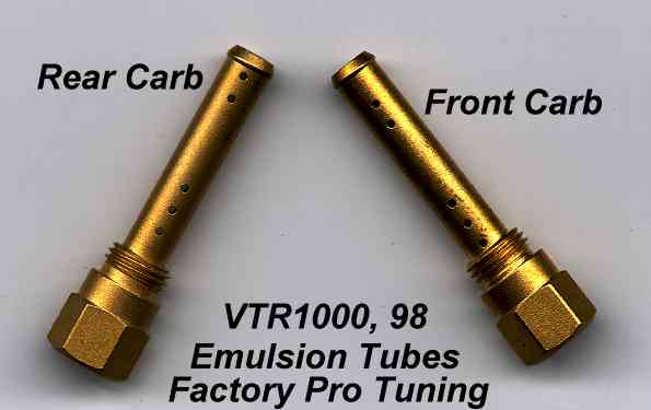

Originally Posted by swiss-storm
mechanic seems to believe it runs too rich as well, and that maybe MAYBE when another garage had stripped it down last year, they may have inserted the jets backwards; explaining the jumping as the rear is now too rich and burning improperly and the front burning to quickly.
The emulsion tubes (part that the main jets screw into) are specific to the front and rear carbs as well. Picture jacked from 8541Hawk:
https://www.superhawkforum.com/forum...sion-tubes-jpg
