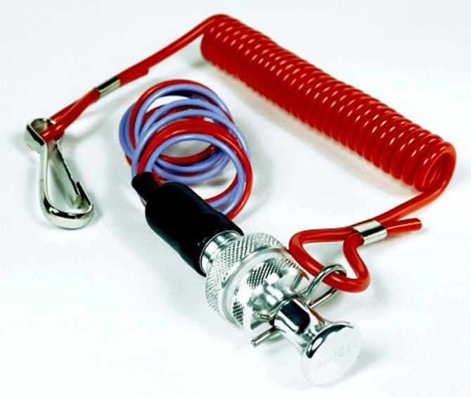

hello, has anyone set up a tether switch on a vtr and what are some of my options? Im looking to do a few street legal drags at my local track and they require a tether. Thanks shawn

Interrupt the hot wire into you engine cut off switch, route it through an add on tether switch mounted to the clip on.
Just a bit of wiring and a way to mount the tether.
Old Aug 9, 2016 | 05:35 AM
A panel mount switch in a simple bracket mounted to a clip on bolt should work.

The old school way to do it used to be to screw a small sheet metal screw into the kill switch, then use a tether with alligator clips on each end that would pull the kill switch if you crashed. Not sure if that would pass tech or not. Or be safe, for that matter.
