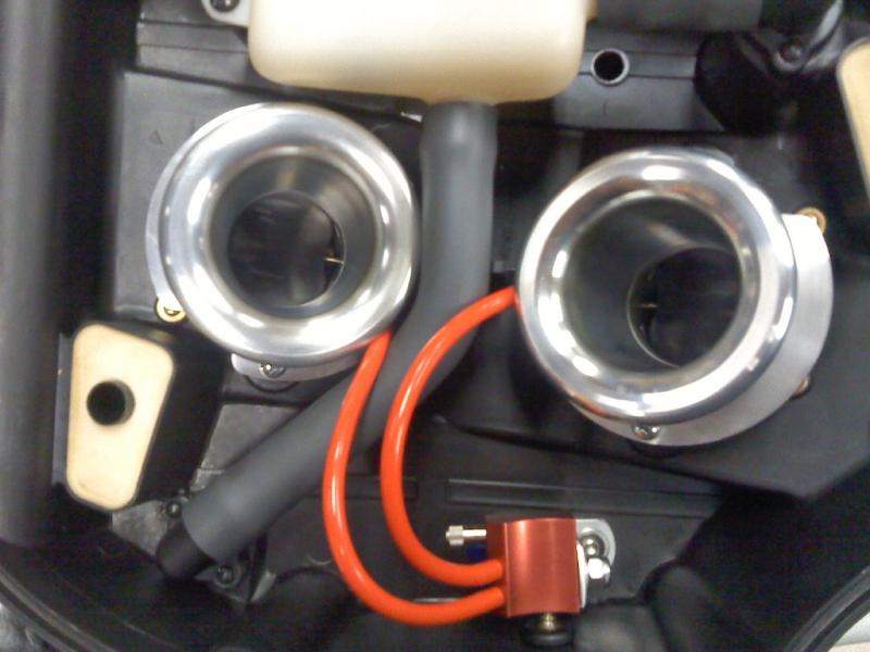

I believe Hawk is talking about these.....
Old Jan 16, 2013 | 12:51 PM
Yes those (or the Mori units they are copies of) are what I mean.
The simplest answer would be that it is not so much the shape but because they are the same length.

very nice pieces! I was asking more about why the aftermarket stacks are different. Obviously if it's length that makes the difference then is it because they are the same length? Is it about the material used?
