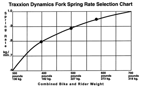

I wanted to beef up my fork springs but not sure to what. I heard they could bottom out easily but thought guys were crazy but mine's doing it on large potholes and stuff. My riding style is fairly aggressive but no track days serious. Now bikebandit offers 0.8 kg/mm, 0.85 kg/mm, 0.9 kg/mm, 0.95 kg/mm, and 1.0 kg/mm from raceTech. Any suggestions? Stock is almost 6
Old Jul 6, 2009 | 06:26 PM
Anything over about .85 and you're looking at a revalve. The stock valving won't be able to keep up with the springs.
What you fail to mention, and is a key bit of information, is your weight.

around 170

Racetech has a weight calculator which appears down at the moment. This page has the link. http://old.racetech.com/evalving/eng...ngname=english
If you tell us your weight, I'm sure someone can tell you off the top of their head. I'm about 165 riding and could use either a .85 or .9. I switched to CBR1k forks and the stock springs were .88, which is just about perfect.

Who you callin' "big", mister?
You might want to weigh your bike to use this spring rate estimate:
