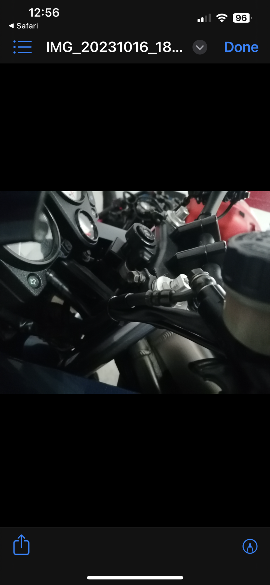

Here are the photos, there is no play in the wheel bearing or steering head bearings whatsoever. I have not checked the tyre pressures but was told they where 36lbs front and 40lbs rear, (on my previous GSXR750 I ran 36 and 36 and found grip improved a lot on this slippery Spanish asphalt) I wouldn't know where to start adjusting the forks but it all looks normal, not been lowered or anything.

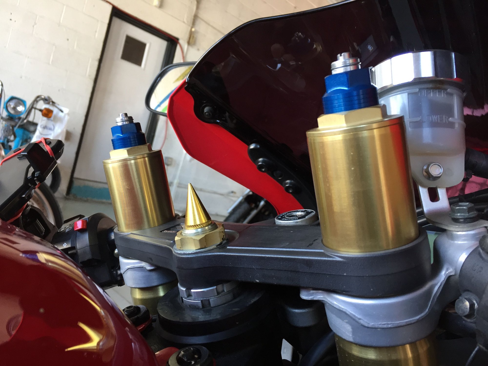

Here's an example of what we were looking for in your pics. Some squids slide their fork tubes up in the clamps to lower the bike. This can completely screw with the geometry that was designed from factory. Yours appears to be fine.

from those pictures are your fork tops near level with the top face of the top yoke? if they are thats were to start. your bike will steer like a chopper and the weight has been removed from the front end..
Ooooh, great catch. ya, your forks are too low in the triples and should be raised up, similar to Wolverine's pic of the yellow VTR. OEM has the bar clamps mounted to the upper fork tubes, looks like your were slid down after the bar conversion... definitely will cause issues.

Disagree. His are low. Wolverine, yours have clipons obscuring most of the fork tube above the triple. Apples and oranges.
Old Oct 31, 2023 | 12:55 PM
Posts: 5,221
OH!! I see it now. Getting old sucks. Little phone.. no readers. Sorry fellers.
Fork tubes definitely need raised!
edit: If you need an exact measurement of how far to move the tubes lmk and I can provide it.

should be the width of the standard clipons plus about 10mm showing, as folks have said the forks are way to far through the top yoke, that things gona handle like a shopping trolly set up like that.
